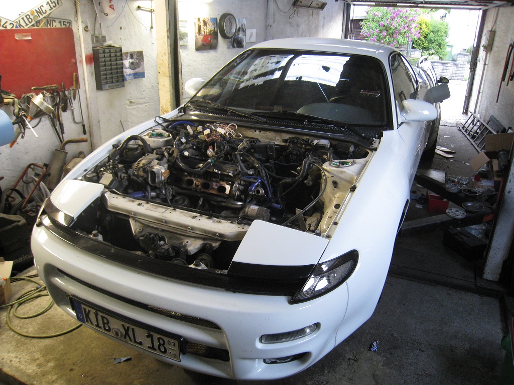

BTW, I made a big progress today even as I started working on my car in the late afternoon after help a mate of me to fix his DD.
Replaced the sealings of the new gearbox, switched over the clutch hydraulic and the brackets, bolted it to the engine and pulled the engine back in it´s home:
Still waiting for the sealing for the turbo, but it´s looking good to get her back on the road mid of next week. :D

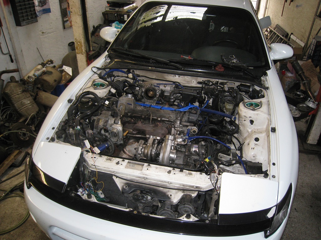

The car is getting together bit by bit over the last days, but it´s more work as I´ve expected. Took two days to refurb the driveshafts. Took them apart, wirebrushed the parts with the angle grinder, resprayed them and assembled them back together with new OEM boot kits. Bolted them back into the car, together with the prop shaft.
Replaced the water pump for the intercooler by a used refurbed one as the old one was leaking and noisy:

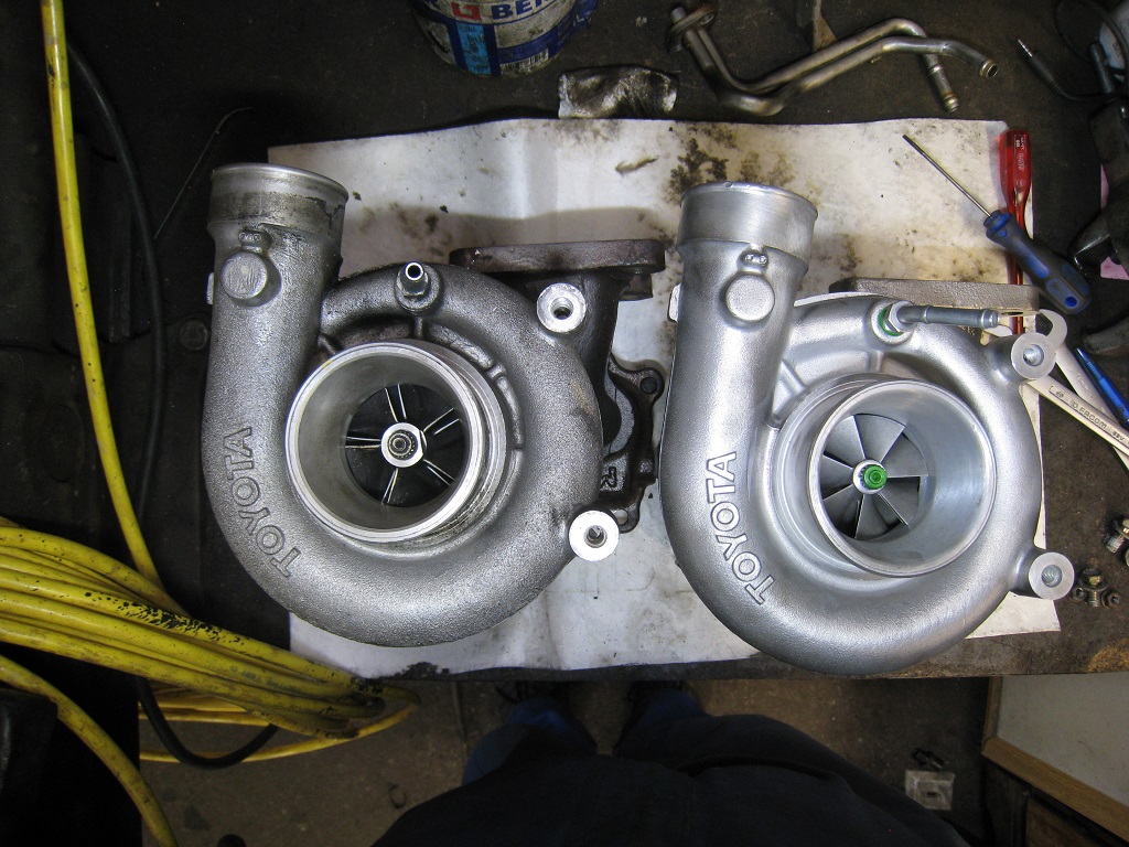

Also assembled the upgrade turbo:
and bolted it onto the engine with the repair welded Aussi downpipe:
Filled the gearbox with oil ( Castrol 75W140 LSD ) and replaced the oil of the rear diff. Also fitted new spark plugs ( NGK Iridium Grade 7 ) ,a new OEM distributor cap and runner as well as new ignition leads ( Ultra Silicone ) .
Still have to do all the electric connections, bolt the exaust back under the car, put the radiator and the intercooler back to their home and assembel all the rest.

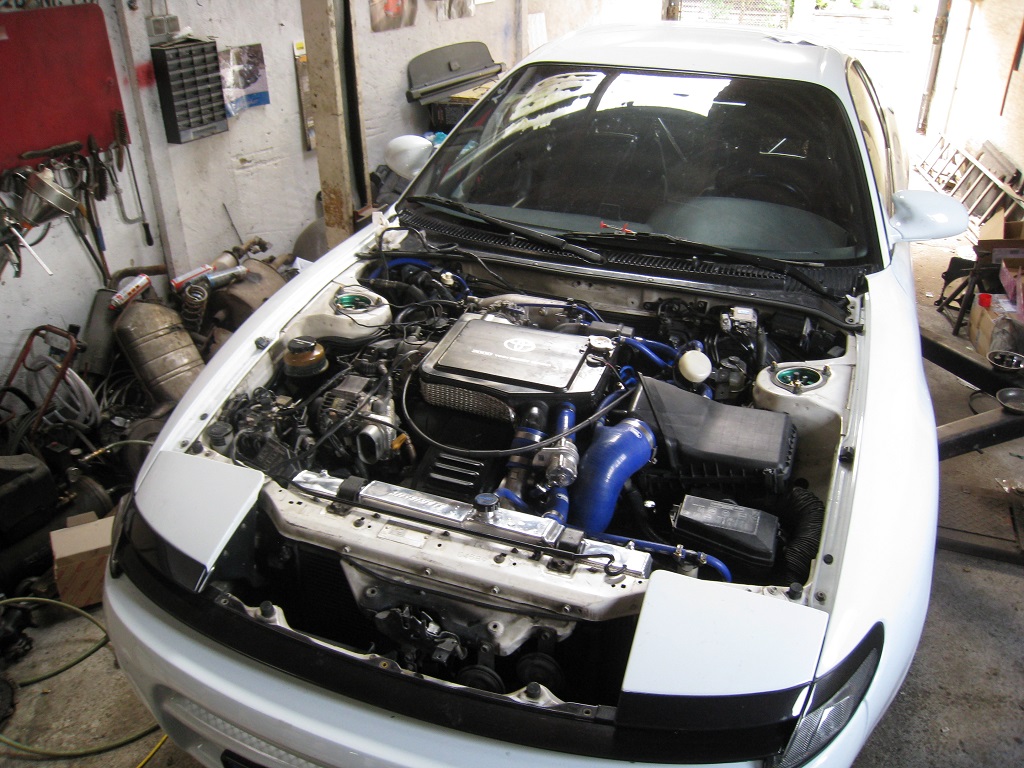

Filled up the engine bay with the missing parts, started to fill up the cooling systems and the power steering:
Switched to the underside of the car to assemble the front axel and bolt the exaust back under the car:
Have to pick up some parts tomorrow but then I have all together to finish this project tomorrow I hope.

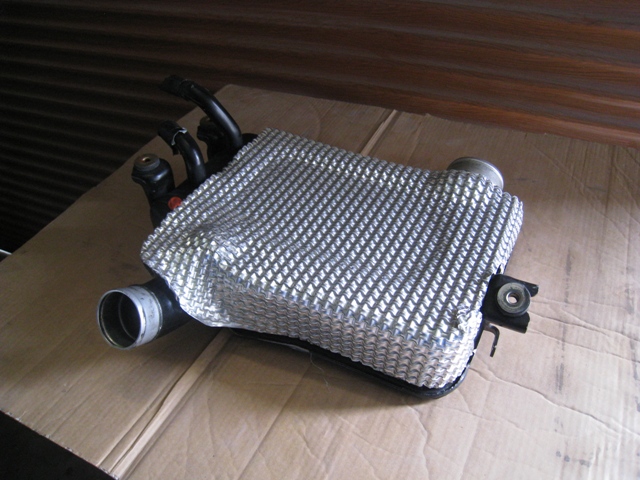

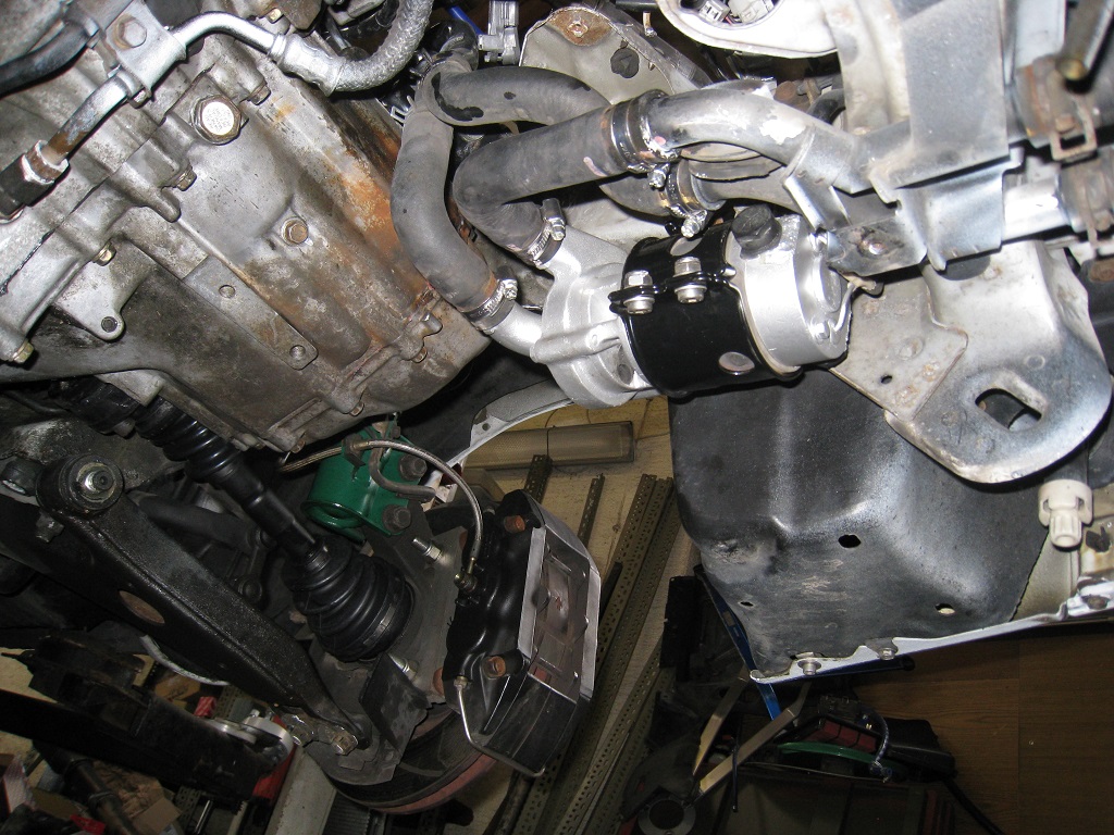

Nice progress. Whats that heatshield material you are using under the chargecooler?
PostPosted: Thu May 30, 2013 8:48 pm
It´s a double layer alloy sheet, specially made for reflecting heat. Easy to form and to cut: http://www.isa-racing.com/product_info. ... child.html
Formed it on the chargecooler and glued it onto it with a heat resisting adhesive:

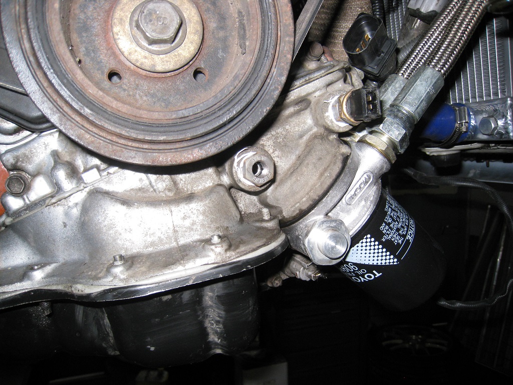

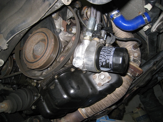

Picked up the last parts to finish the project today. Had two adaptors made at a local machine shop to place the sensors for the oil gauges direct in the oil pump. Wanted to get rid of the sandwich plate where the sensors had their home as the old solution was crap and costed ground clearence:
This is the new solution:

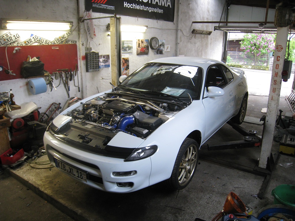

With the sensors in place I was able to route the last cabels and finish the project. Only have to put the hood back on:
