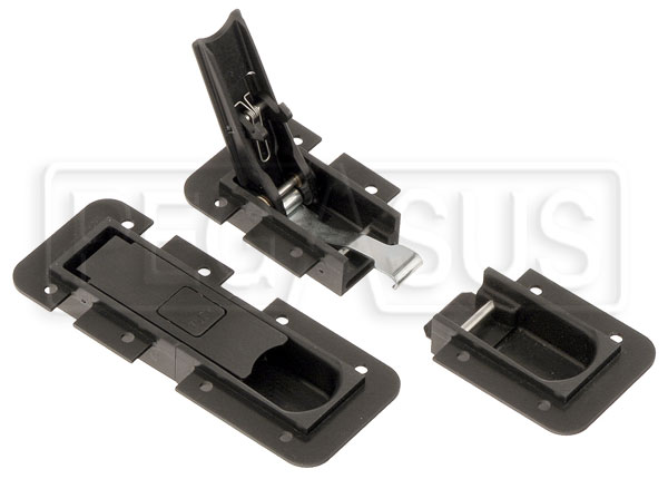

Not the aerocatch 3 that are used on panel gaps like the wings to bumper joint. But the normal aerocatch ones for mounting bonnets and flat panels have a lockable option, some people use these on a flat surface at the front of the bumper, with the pins fixed to the bumper bar behind

Aerocatch 3:
