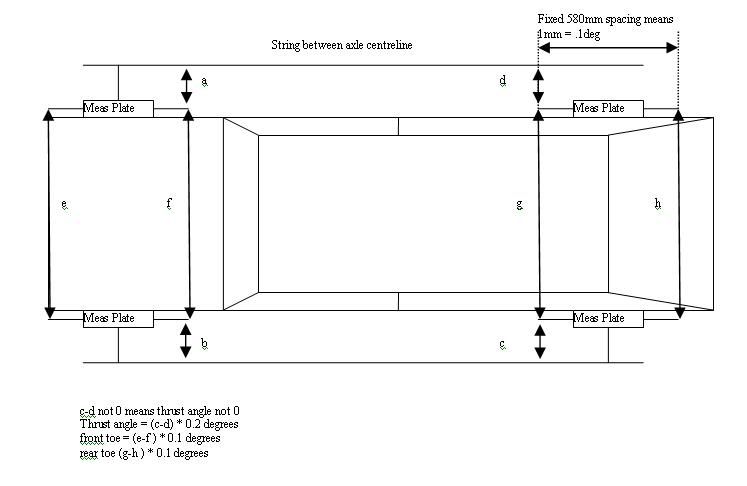

So I'm going to revert back to old school basics with a tape measure and calculator. I think I've designed a jig (during lunch if the boss is looking :D ) which will allow me to measure toe and camber, thrust angle and possibly even KPI. I should also be able to measure ride height and I have the beginnings of a plan for corner weighting too if I can find a suitable hydraulic setup

PostPosted: Tue Jul 07, 2009 4:11 pm
First pass at a wheel alignment frame. 4 will be required, one per wheel
(image in full res here)
PostPosted: Tue Jul 07, 2009 4:38 pm
How to use it for toe and thrust angle

It should be possible to measure KPI by taking camber measurements at +10deg and -10deg of steering input. This will require the construction of a wheel angle plate. I have an idea for that :lol: and using two of said plates will allow Ackermann angle. A bit of indiannudity should also allow scrub radius calculation too

I should add that the adjustable height means that it should be possible to use this on a non level surface (within reason). This means it should work on my drive
Using a 4 wheel "U" tube water spirit level, one per alignment frame, means I can set all of the hubs at the same height.

Stringed it up the old fashioned way. If you squint you can just about make out the fishing line I used ;)
(Just for Kris, it was stren 40lb test shock leader :lol: )
Offside rear was toed in by 1.5deg, ns rear toed in 0.5 deg
Both sides now toe in 0.3deg :D
Car now goes in a straight line with the steering wheel centred :lol:

Did you lock the steering wheel/front wheels in the straight ahead position to get the string lines aligned or did you just eyeball it?
PostPosted: Sun Jul 12, 2009 11:12 pm
Measured it
It doesn't actually make that much difference - there's a screw centred on the hub for setting up the strings. As you turn the front wheels the head of the screw doesn't actualy move in very much for the first few degrees of turn
It's all down to sine waves ;)
