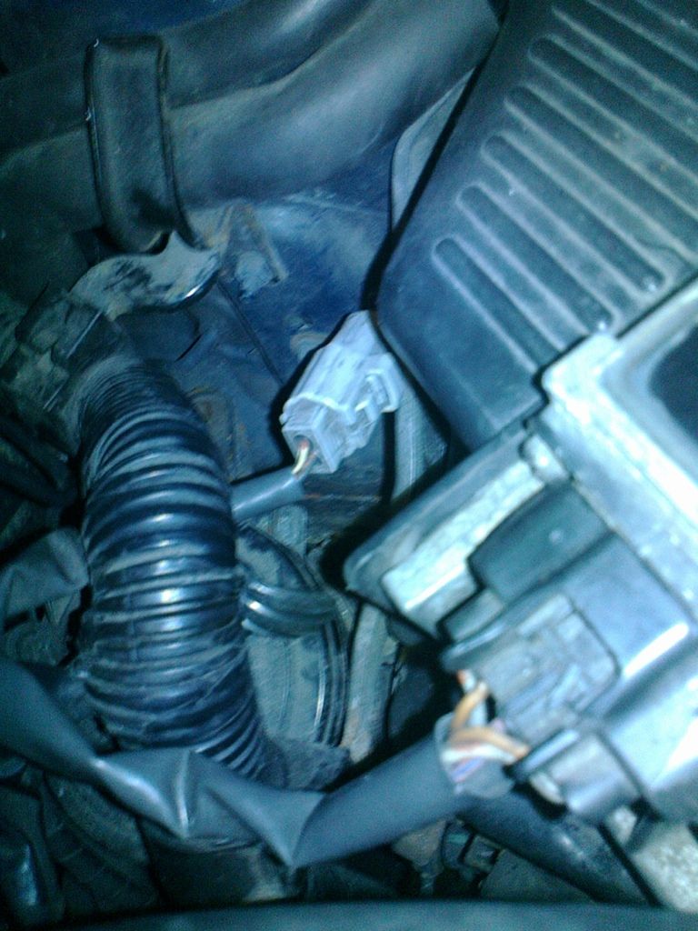

I also found a grey 2 wire (brown/black yellow/black) plug connector just behind the air filter which was dissconnected??? It goes to earth on the suspension turret just below the air filter so I reconnected it. How long this had been off, I do not know (It may just have happened)

Intake temp is built into the AFM on a 185. Mine doesn't have a grey plug that I can see. Might be related to the charcoal canister or EGR.
Crackling noise is probably solenoids or injectors clicking in & out.
If it ran without the grey plug in, I would try taking it out and try again.
Can you post a picture of the grey plug and he item it plugs into, maybe we can identify it.

just noticed wire colours on plug, I'll have a look later.
does sound like alarm or switch gone bad to me.
PostPosted: Sat Feb 09, 2013 12:48 pm
Couldn't find those wire colours anywhere on the ECU or air con circuits.
Does this give a clue ?
PostPosted: Sat Feb 09, 2013 3:07 pm
I also failed to find the colours but I only have the bogo 185ewdthatyou posted the other day. Since Jeff's is a CS it may be specific to that
Looking at the ewd black/yellow seems to be a common switched 12v line but it might be something connected to the alarm

Eek and thanks guys.... I cannot zoom in enough to identfy the conector but believe it is not the problem....

The connector, which was disconnected after I removed the air filter but I may have just done it?? is in the middle of the picture. It goes to earth on the turret via a 3/4" cube black box???? !

Here is the picture that jeff uploaded of his little grey plug
PostPosted: Sat Feb 09, 2013 7:49 pm
I have a plug like that on mine with black wires going to it and it's a suppressor capacitor. Not sure what it supresses, but I doubt it makes much odds.
