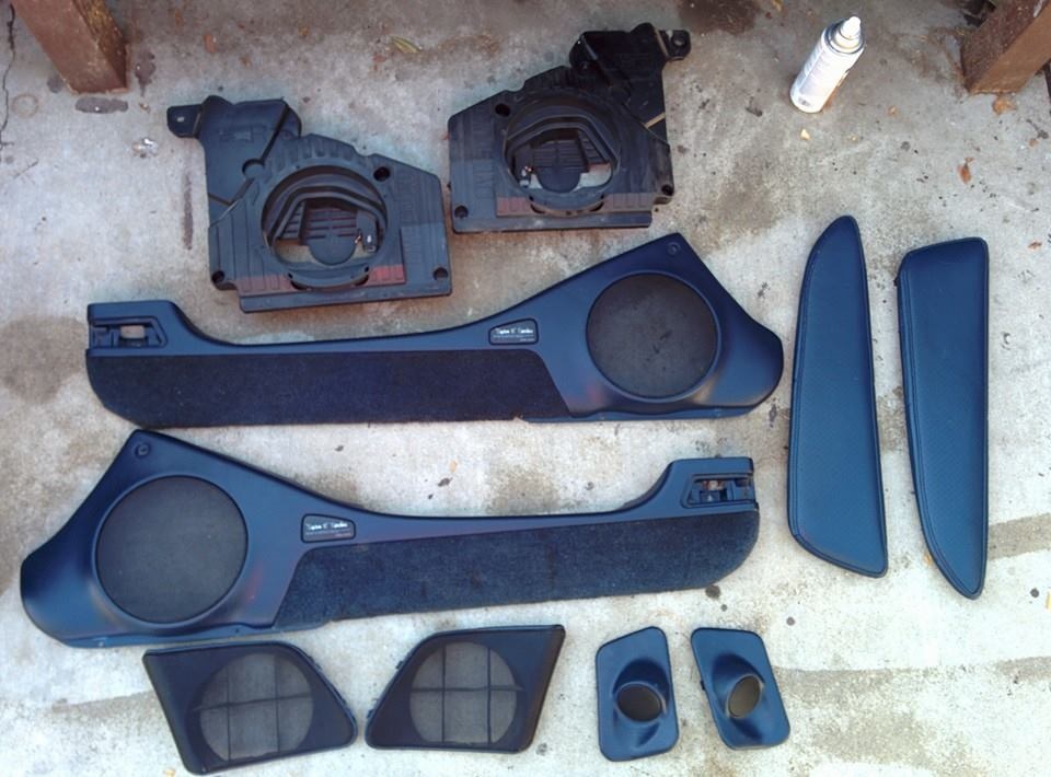

Sometimes all you need is luck. Stumbled over an offer of a 10 Speaker upgrade package on facebook. Wasn´t expensive but the shipping from the US doubled the price. :(
All the speakers are missing, but I will use better modern ones anyway. The front tweeter covers was missing too, but I could buy a set of them from a breaker in UK .

Get the front tweeter covers from the dealer. Most have broken tabs from being removed, which will prevent then from sitting right and often falling off when closing the door. They are cheap enough new.

They´re still avaible ? Do You have the part numbers ? Unpacked the set I bought and one indeed got a broken tab. :-(

Try these:
67491-20190
67492-20250
http://www.toyodiy.com/parts/p_U_1992_T ... _6701.html
I bought some a couple years back since all the ones I collected from wreckers had broken tabs.

I´ve got in contact to Matt, who sold me the covers. He will send me a intact cover on his costs. But I´ll check if the covers are still available new in the next days.

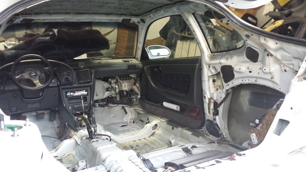

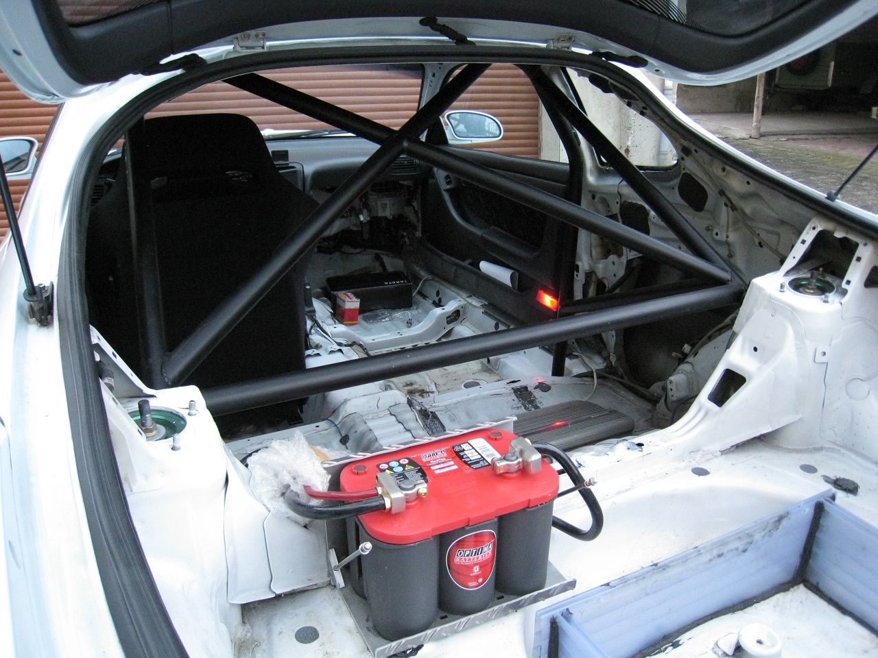

Had a week off from work, so I started my winter project:
Now my CS is at the body shop who did the shell repair after the crash in 2011 to got the base plates for the roll cage welded in.

Received my car back today.
Was a good decision to bring it to a professional to get the base plates welded in.
They still had to invest some fabrication work in the plates.

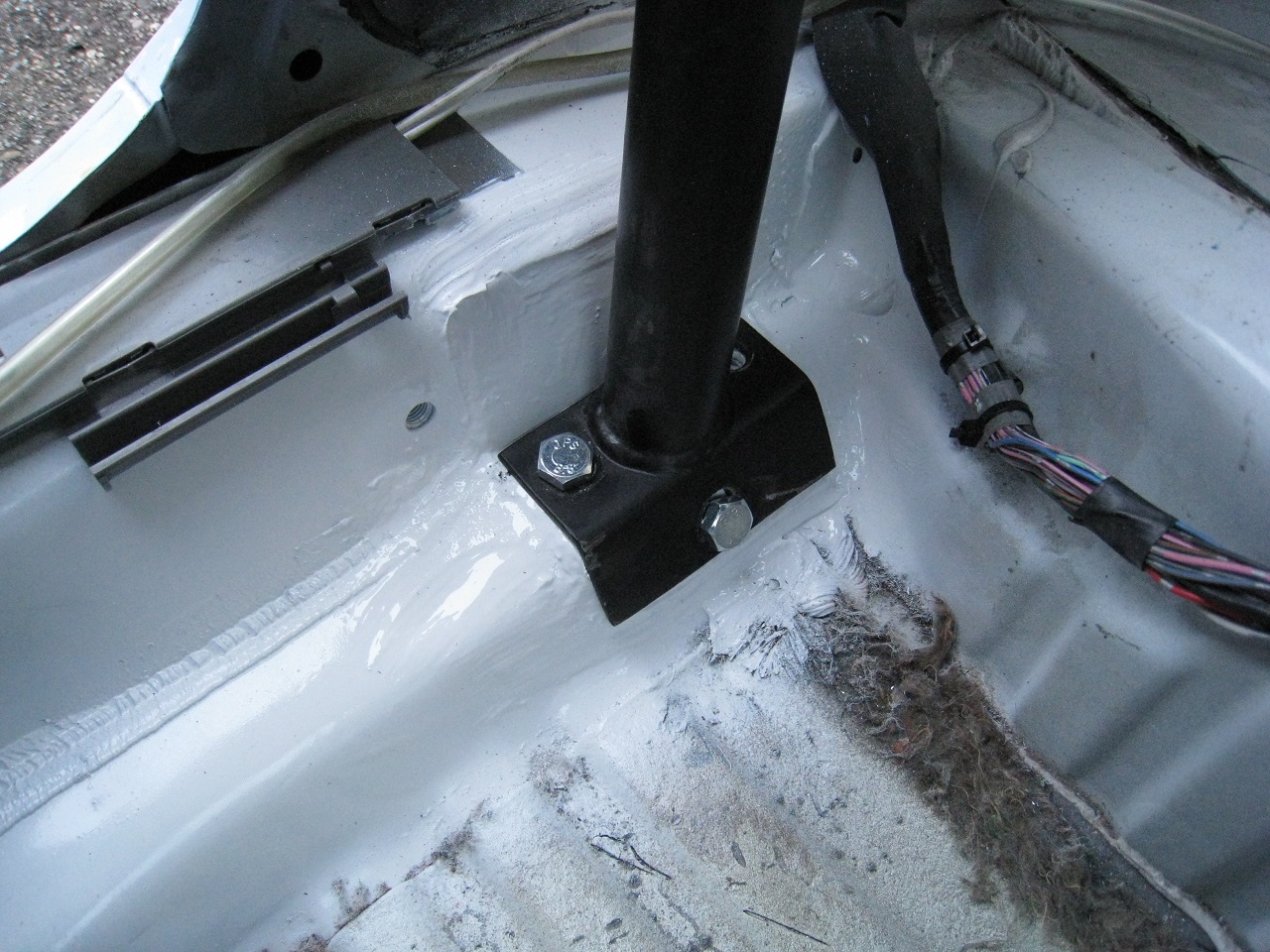

The lower front ones where copied, equipped with welded in nuts and got welded to the undersite of the floor pan addtional to the ones that came with the cage that are welded to the inside of the car:

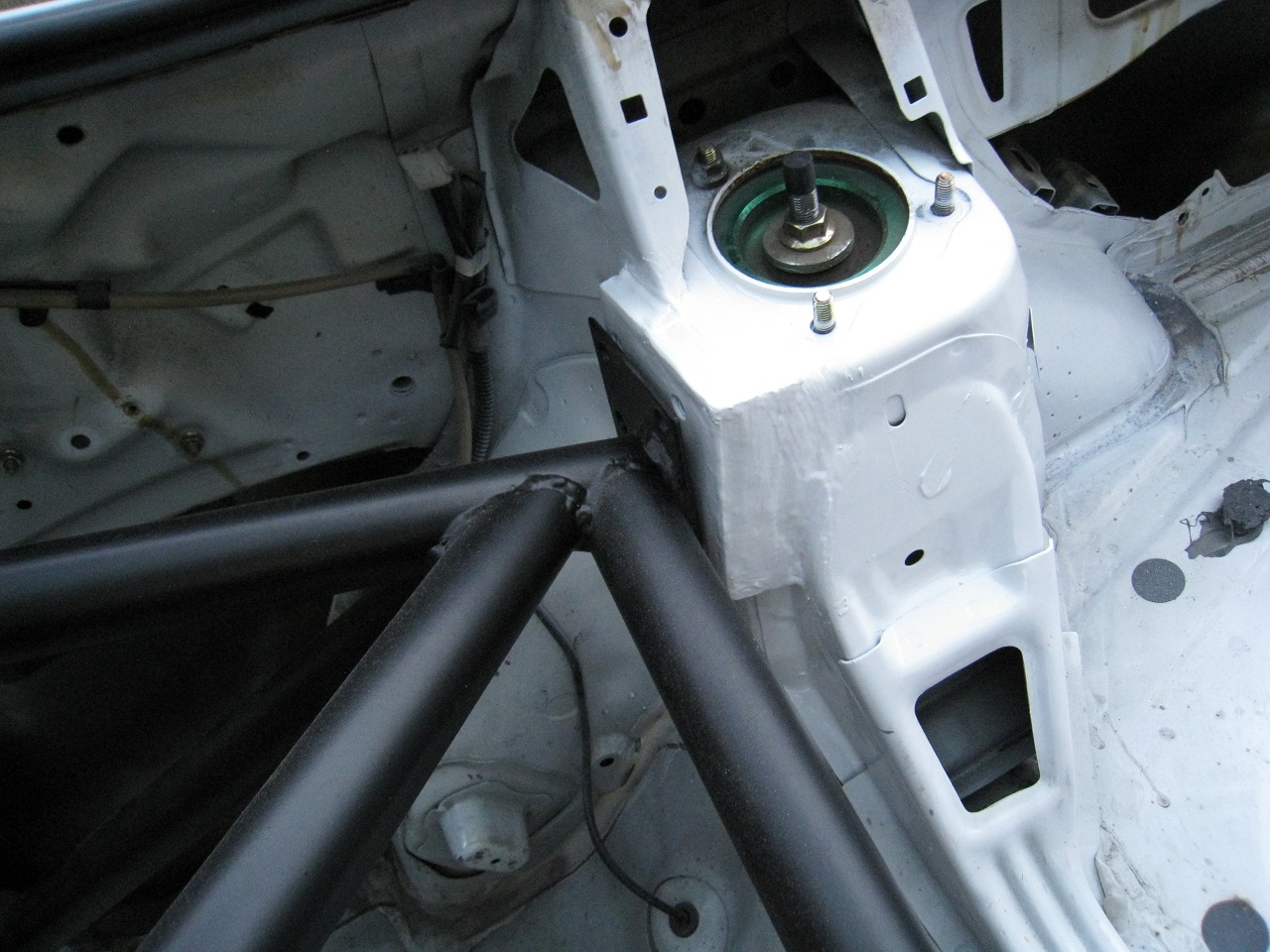

They also made new plates for the rear end as the cage was a bit too short. They fabricated thick plates with integrated threads and welded them to the suspension domes:

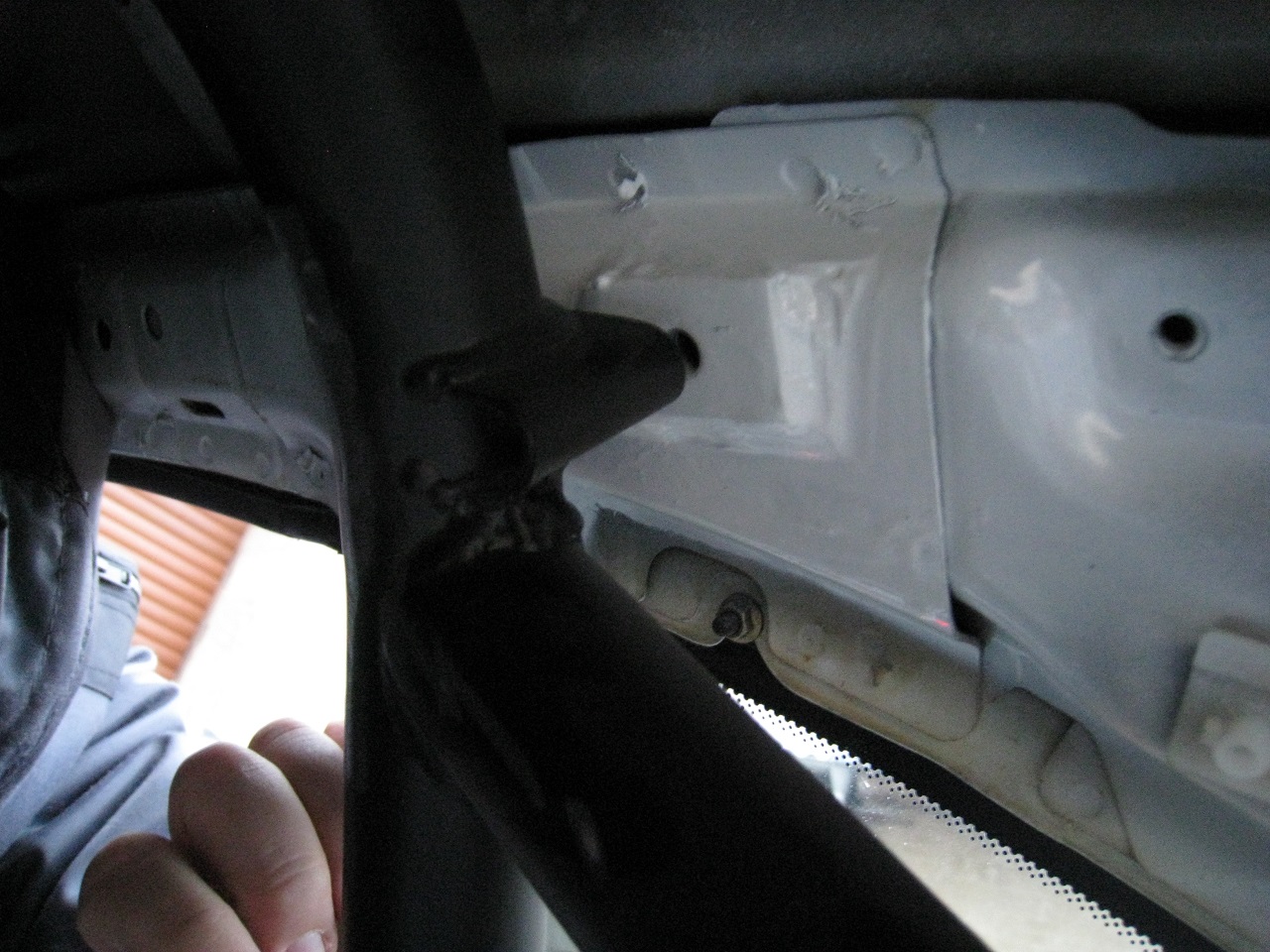

The upper fixing plates that came with the cage was welded in as scheduled:

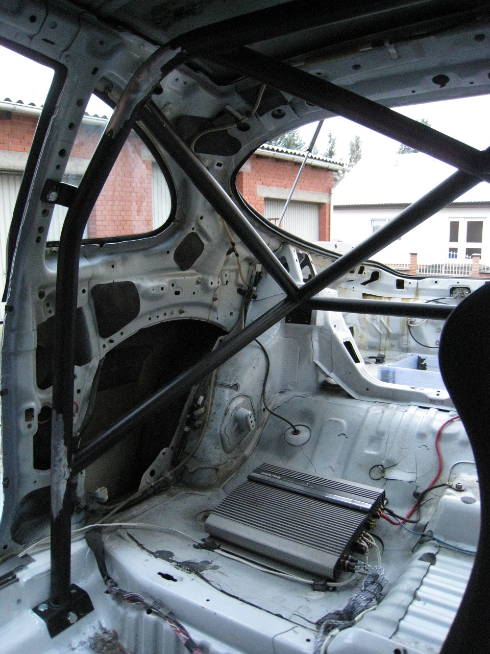

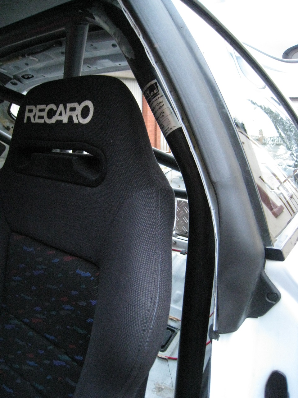

The space behind the seat is extremly limited so I let them cut off the extension brackets for the optional front extensions to make a full rollcage out of the rear cage:
As next I´ll test fit the roof liner and the side panels to see what I´ll have to cut away. Than the cage will be took out and will get painted Porsche Firnweiss like the car is outside.

Already cutted out the panels, the roof liner and the carpet for the cage. Now I´m waiting for some carpet dye to dye the faded carpet before I put it back in.

Nice job of fabricating the cage install :) Interesting to hear of your experience with the fitting of the pre-fabricated cage not being exact. This experience isn't unique to Safety Devices. Unless you get the cage built into the shell then you really have to be prepared to do some extra fabrication to get the fitment right.
