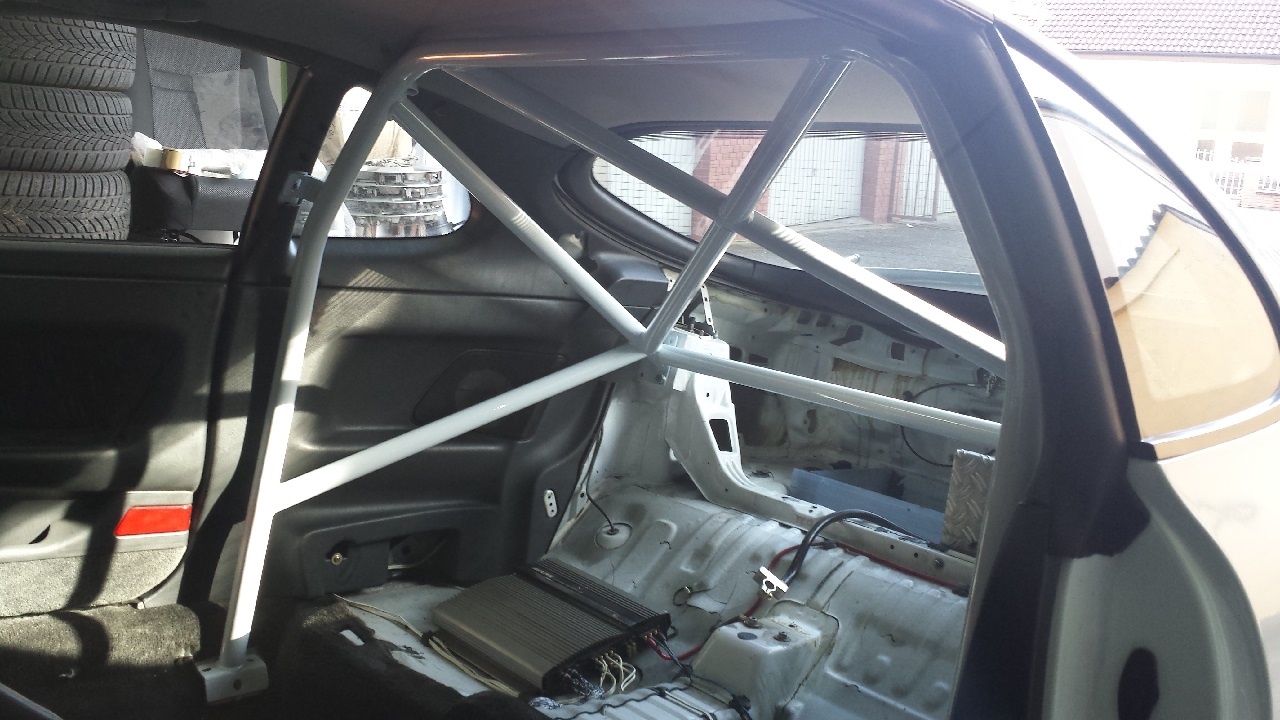

Today after work a mate from work helped me lifting the cage into the car and bolting the passengers door back to the chassis. Bolted the cage only temporary as I ordered nicer looking and stronger srews yesterday:

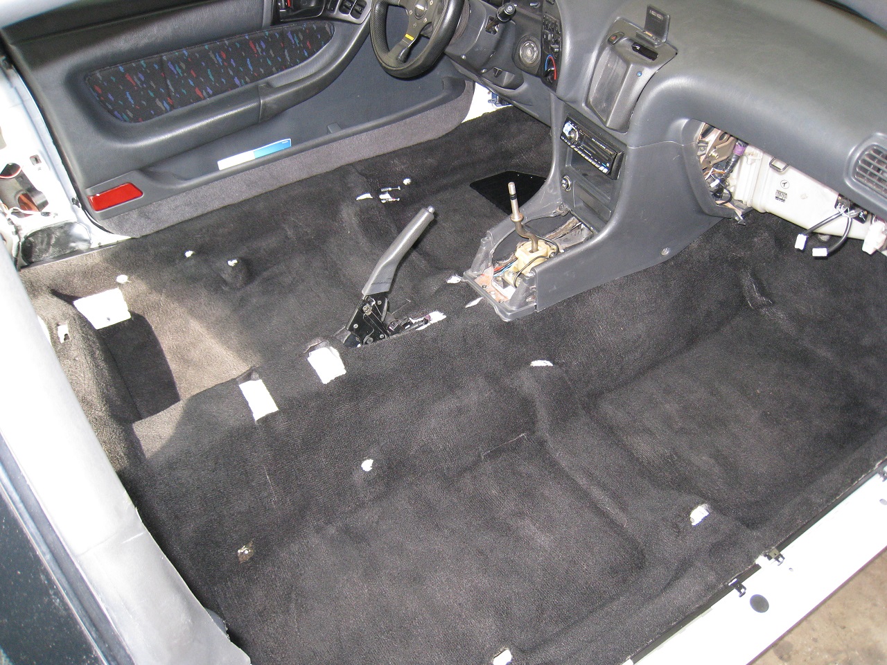

The carpet is already in the car. Had to put it in before the side panels where put back in place so I could fit the cage.
I know your Recaros. Remember who told You about the Bride rails on Facebook and You bought the EU spec mirrors from ? That´s me. :D
My mainly black Recaros where the matter I´ve dyed the carpet black too. Think it will match way better than the grey carpet.

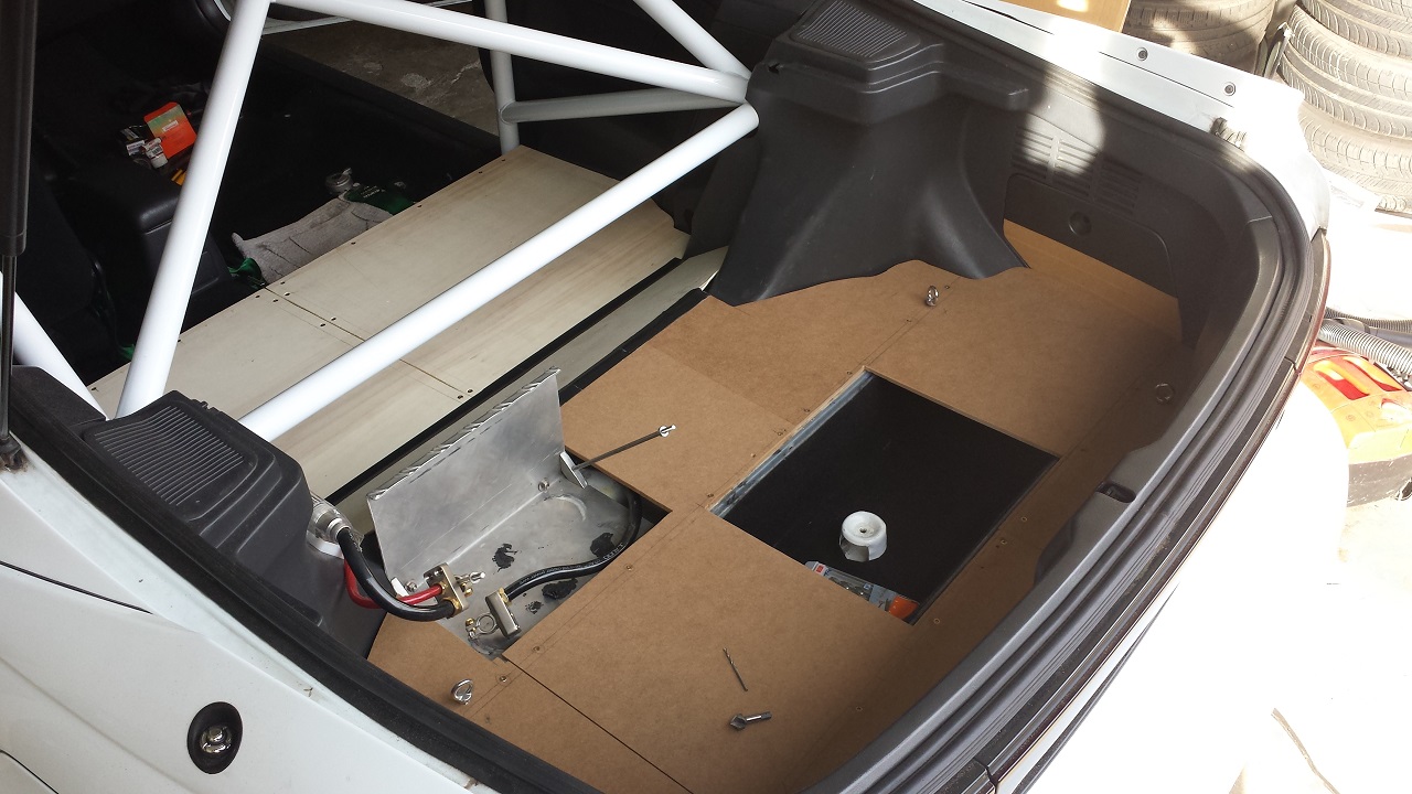

Had to made a new floor as the old one out of plastic panels didn´t resited the extreme temperatures. This time I´ve choosen wood plates, 6mm thin light three layer wood for the front floor and 8mm thick wood compount plates for the trunk. Gone this way to receive a trunk floor that is capable to carry my luggage for road trips. Also integrated four removable stainless steel loops I can fix the luggage to.
The front floor sits lower than the last one as I wanted a less massive look and a more even level instead of a ramp. The front floor will also receive a helmet box from OMP in the near future to store my racetrack shoes and cloves and smaller luggage. Luckily I could modify the old aluminium framework that carry the floor so I didn´t had to build it new.
The floor with the addidional ramp area between the two main floors with the plates srewed to the aluminium framework:
Ended up in a nice result, I think:

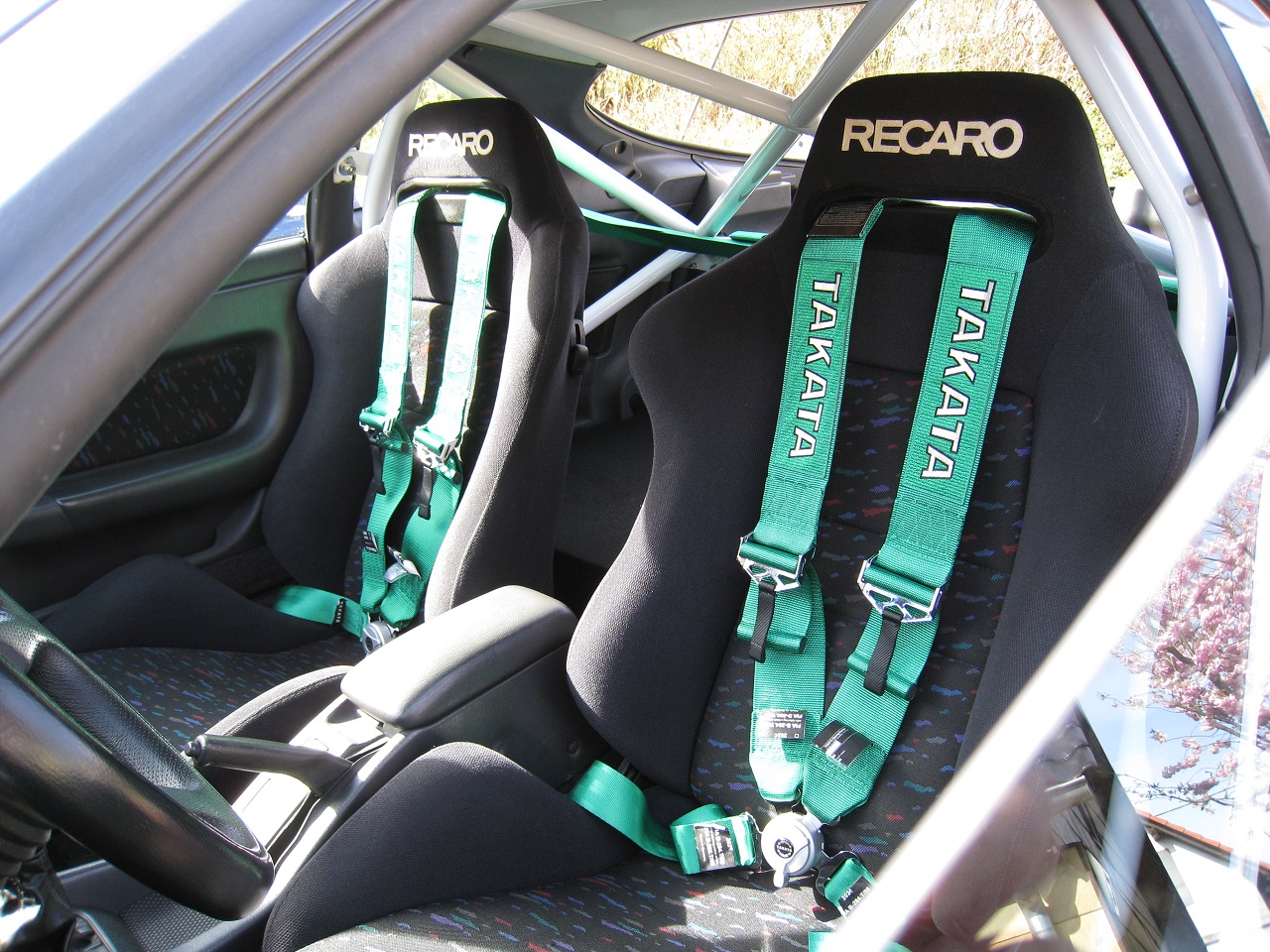

Front view with the new Takata harness belts:

That looks really nice - very clean and neat install.
PostPosted: Sun Apr 12, 2015 7:04 pm
Great quality of work. Looks terrific!

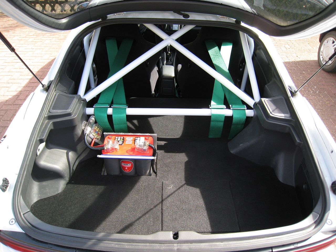

Very neat result man. Looks like you're still able to put in the parcel shelf as well, for road trips? I always missed having some storage out of sight in the CS after I stripped the rear.
PostPosted: Sun Apr 12, 2015 7:45 pm
Theoretically I could, yes but I´ll have to stick the brackets for it back into the suspension dome covers and put the hooks for the strings back onto the tailgate.
Oh, and I´ll would need to buy a parcel shelf again as I sold mine years ago. :D
