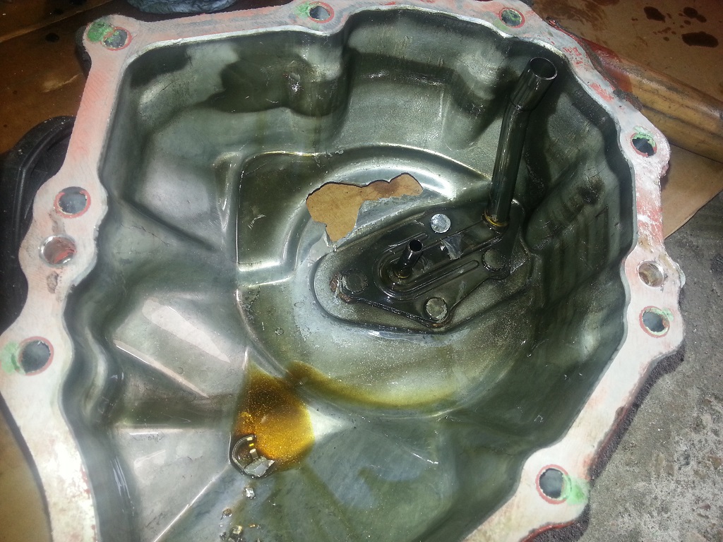

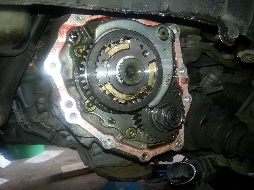

Opened the box today:
Looks like it will be done by replacing the 5th gear syncro. Hope the car will be running again soon.

PostPosted: Wed Apr 17, 2013 2:12 pm
Ouch
Hopefully just replacing the hub will fix
I was expecting a broken fork, not a smashed hub. Interesting this is the second in a short time we have seen. I wonder if this is just coincidence

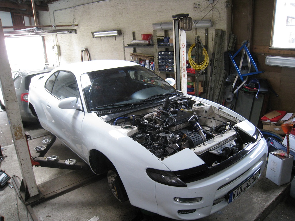

Drove the car to a mates garage today as he has a car lift. Also ordered the engine and gearbox sealings and the v belts. All the other missing parts arrived over the last weeks.
Took two weeks off from work and so the project engine/drivetrain rebuild will start tomorrow.

First day is gone. Engine is disconnected, braces are out, frontpipe is removed as well as the probshaft. Driveshafts are bolted off and just have to be took out.

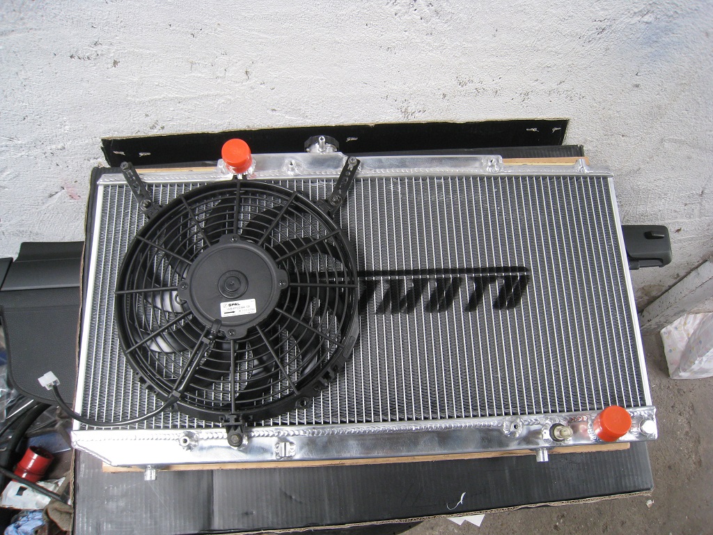

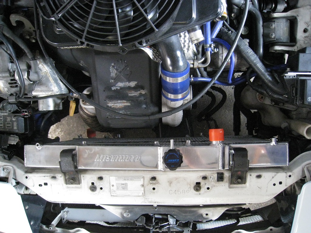

Also testfitted the alu rad but it is so thick that there is no chance so get a fan between the rad and the Aussi downpipe:
I´ve bought two Spal fans, but because of this I only can use one of them:

I thought the ST185CS/RC used 'push' fans mounted in front of the rad, or was that just the TTE ST185's? I'm an ST205 jockey so not familiar with 185's :oops:
PostPosted: Wed May 22, 2013 11:01 pm
Only the TTE ST185 hat two push type rads with kevlar shrouds. The street ST185 Turbo/RC/CS had a singel pull type fan plus a 2nd smaller pull type one if they was fitted with aircondition. The radiator setup is the same as on the ST205 with the rad for the intercooler system a few centimeters in front of the main rad.
