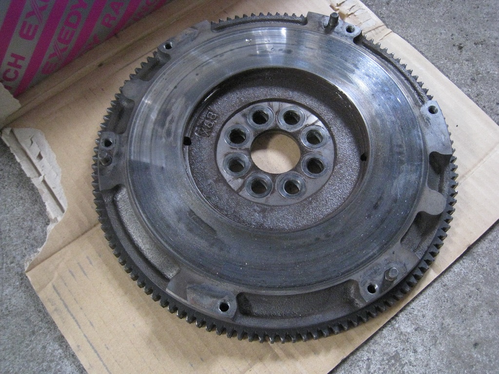

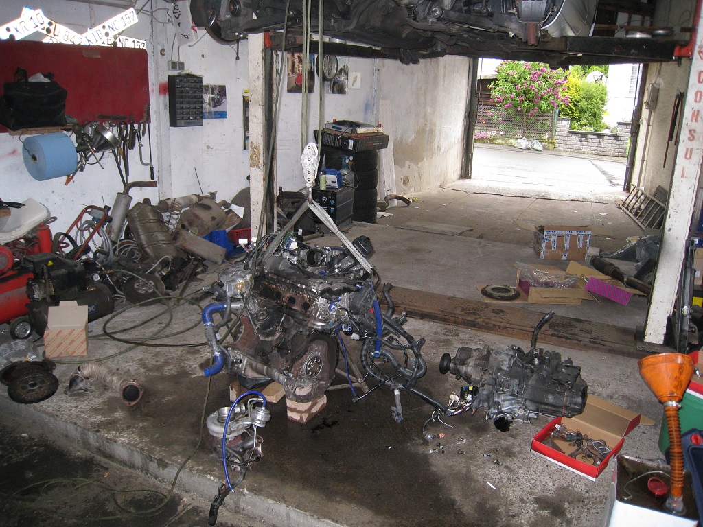

Here comes my progress of the day. Engine/gearbox out, gearbox removed as well as the clutch and the turbo:

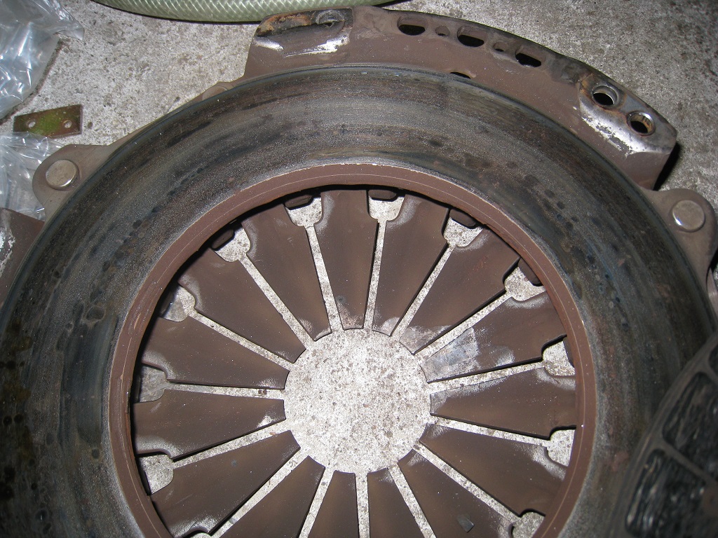

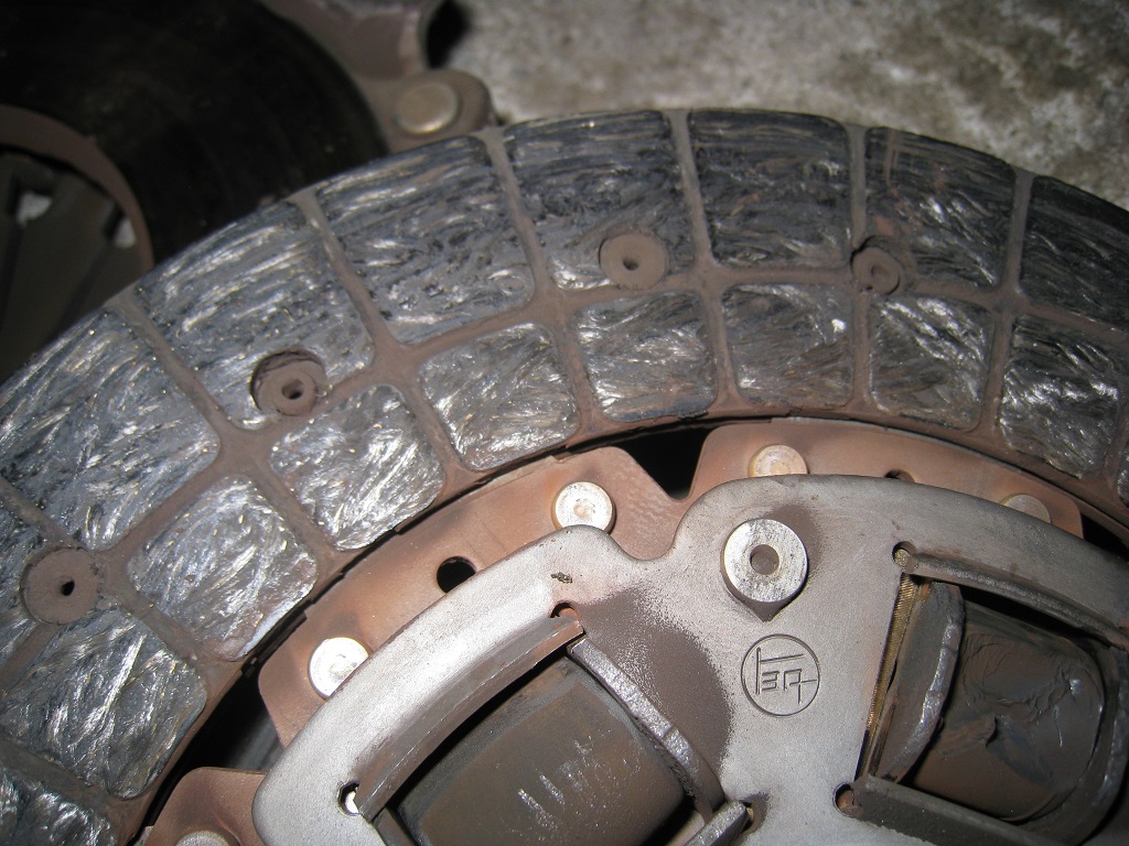

The surface of the flywheel and the clutch plate showing much signs of overheating:
and the clutch discs is nearby worn out even as it only have 70k km done:

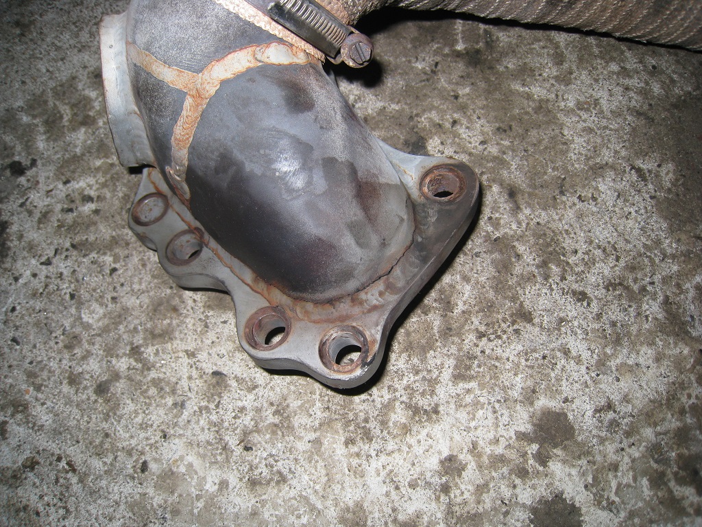

As usual I found more things to repair than expected. Will have to get the Aussi downpipe welded as it is cracked:

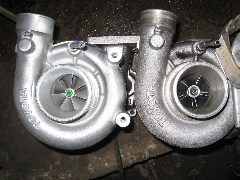

Removed the turbo as I suspicious it to cause the oil consumtion the car shows since the last year. Will be replaced by a custom made upgrade turbo:

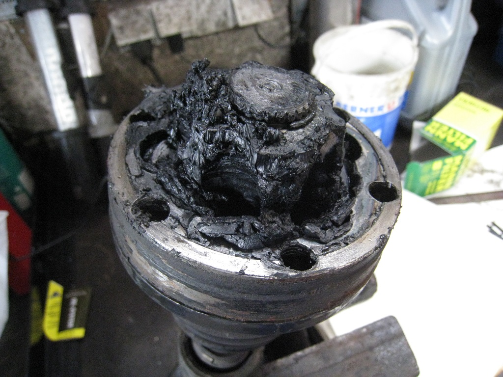

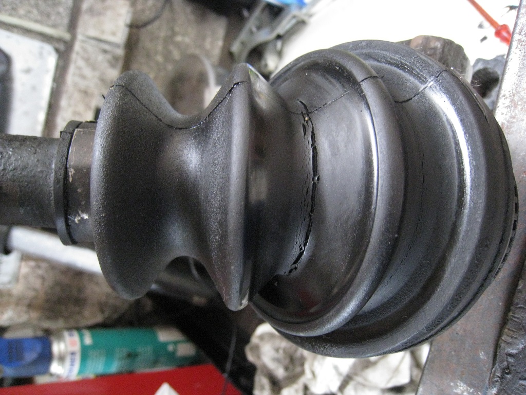

Also startet to overhaul the driveshafts as I´ve seen that they are aged:
What I didn´t expected was to found extremly aged greese. It´s so hard than I can cut it with a knife:

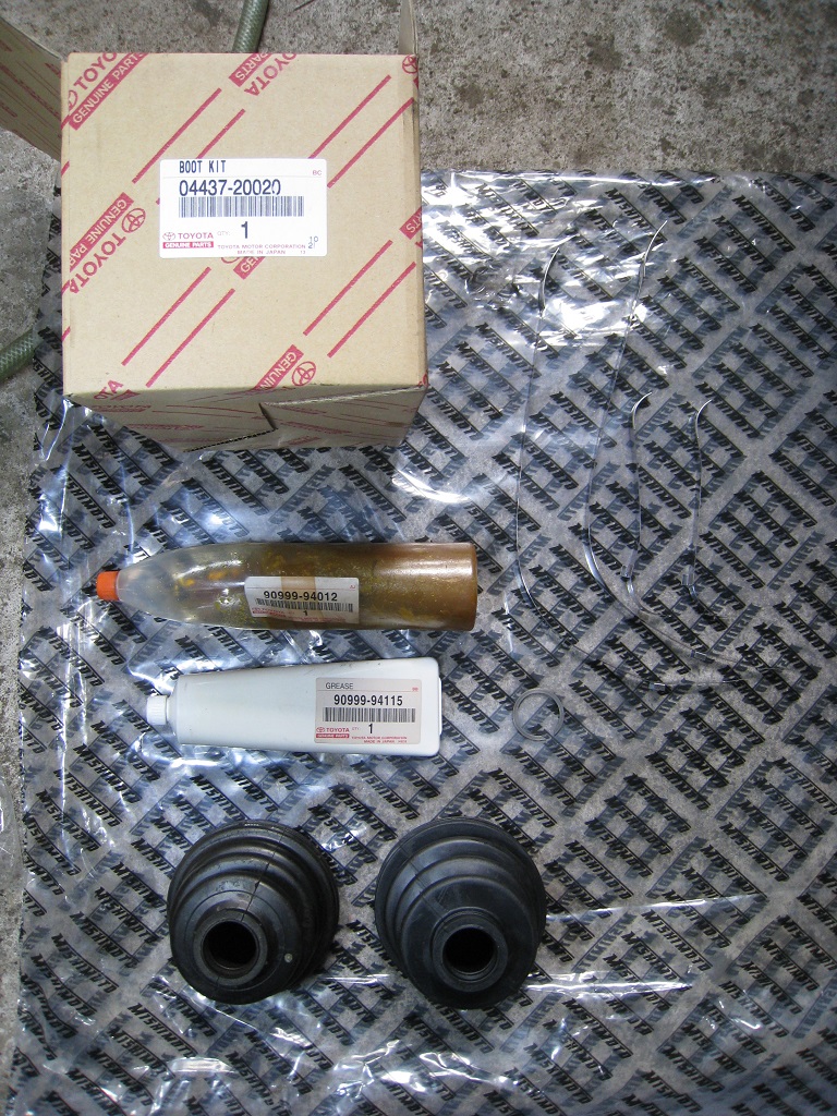

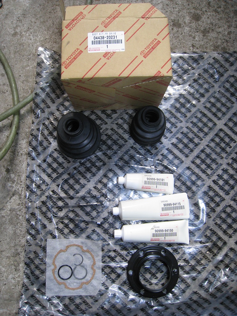

Good that I´ve bought the ultra expensive original Toyota boot sets for the front and rear driveshafts. Costs 446 € all together, but came with all the bits needed taht aftermarket boots most times miss.
Front:
Rear:

After having tried the usual 'Optifit' boot once, I am only buying Genuine Toyota boots (or other parts) ever since. They are really worth their price and will outlast the cheap thin Taiwan spec Opticrap. Good to see you're following the same principals.

Hi Eric,
nice crack on the DP, what was the reason?
on my one i didnt used the lower support bracket, the aussie wasnt weldable (to much damaged) so the only one fast available was a cheap ebay one
.....last long until today

Sunny wrote:
Hi Eric,
Don´t know why it cracked. I belief it´s more a ask of time until any DP cracks. Sooner or later they all will do. My Aussi DP is in the car since 2008 and done 30k km since install (including the support bracket) .Not a big thing to get it welded as it´s only one little crack.

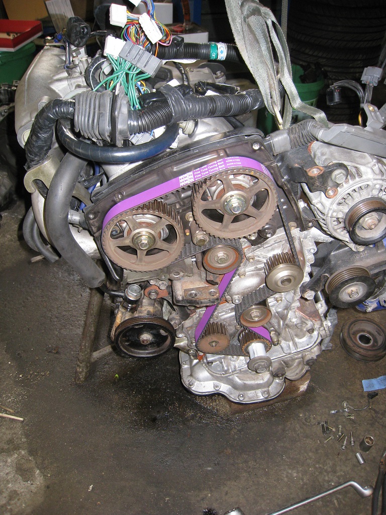

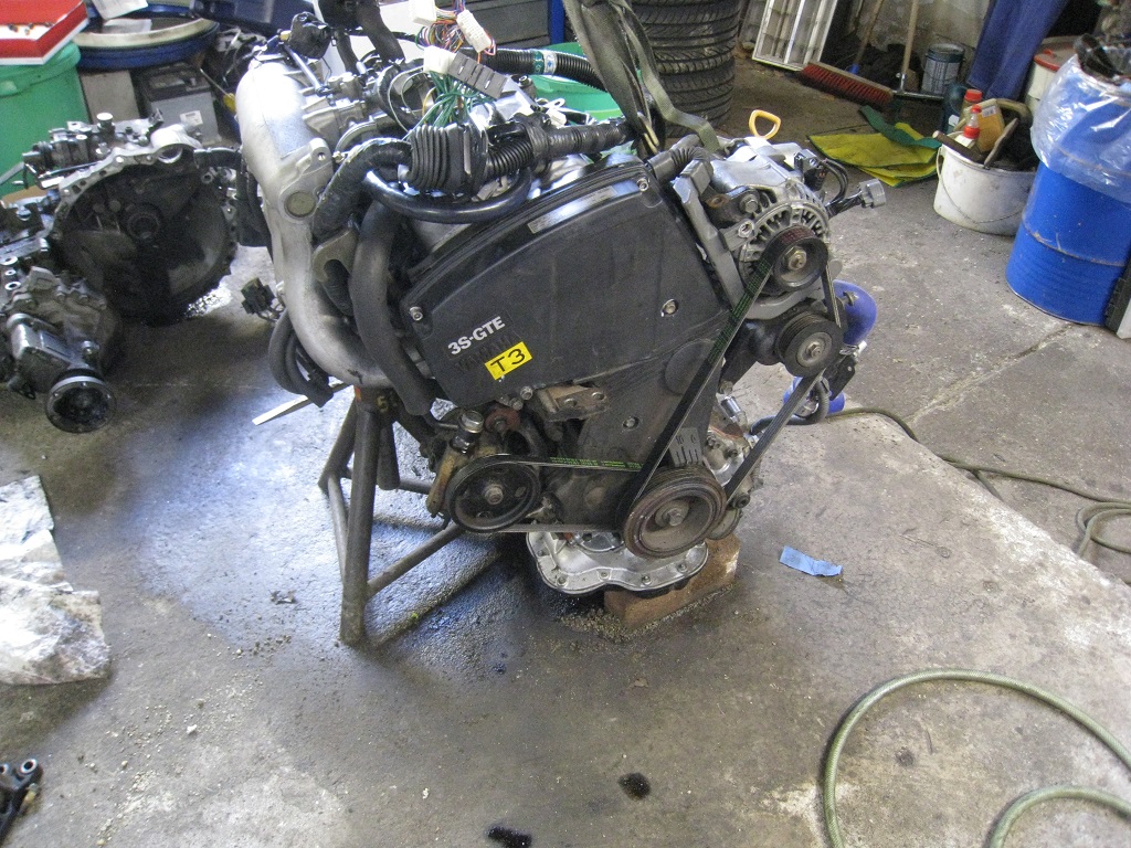

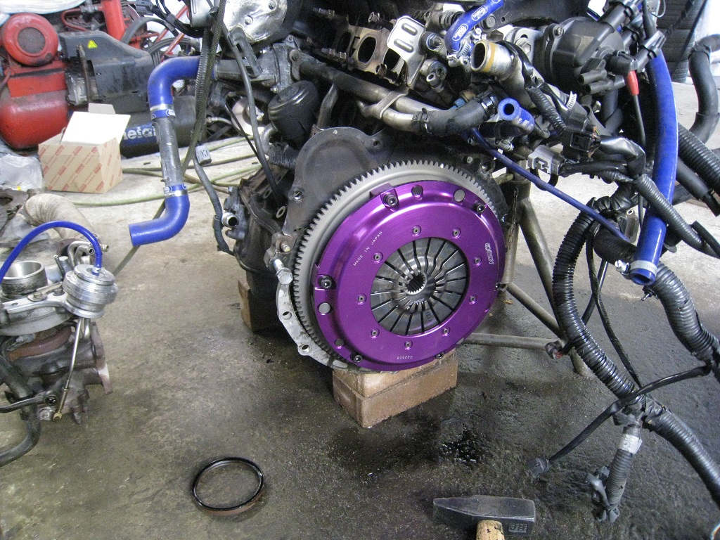

Worked on the engine today and carryed the new gearbox from my shed to my mate´s garage I´m working on my car.
Replaced the crankshaft sealing and installed the new clutch including the new flywheel the Hyper Singel came with:
Than worked on the other end to replace the power steering pump after cleaning up the mess the old pump leaved behind. The pump is a used ST202 one I´ve bought cheap from a friend. Also replaced the crank and camshaft sealings and the timing belt. Used a timing belt from HKS I bought at the german MR2 board as it was a good deal and sure an upgrade, even as it isn´t necessary:
Finished with new OEM V belts:

I've heard and seen more cracked Aussie pipes than eBay ones by far. The two eBay pipes I've had ( one bought alone ) and one free with the xs stainless system are still fine after 140,000 miles over 7 years and the one I sold on has done 5years of service with no issues.

Could it be down to bad fitting and hitting the engine or sub frame?
Anything under stress will eventually give up.
Exhaust alignment is very important, so sticking an after market down pipe that is not exactly the same profile as the original CAT down pipe can cause problems?

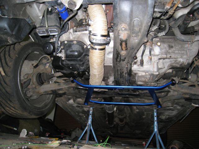

PostPosted: Fri May 24, 2013 10:58 pm
The downpipe is fitted without tension on it and don´t have contact to other parts. But the fronpipe is in permanent contact to the Cusco brace under the front axel:
There isn´t a way to avert this as the frontpipe is 3" thick.
