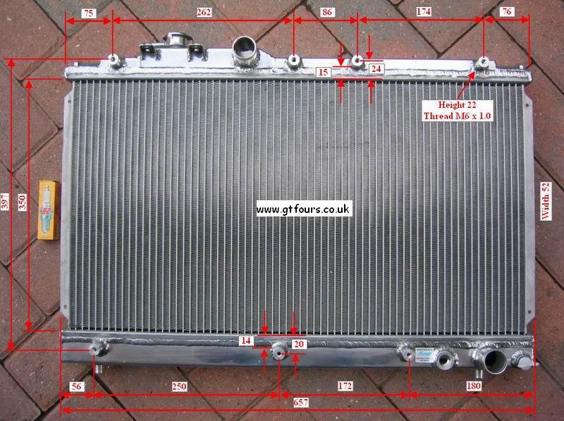

okay i have been searching for a koyo radiator thread where i posted a full set of measurements for the standard 185 rad.
there were i thinks koyo measurements also on this post but i seem to have lost it.
if anyone knows where it went i would be greatful.
i am looking a buying a koyo race ali rad and shoe horning it into my 185.

This picture has most of the dimensions:

Most excellent Kris thats one of them now i have to find my 185 measure up picture to compare.

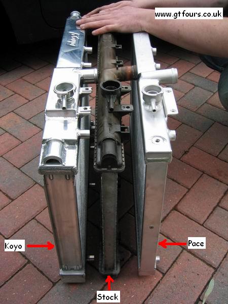

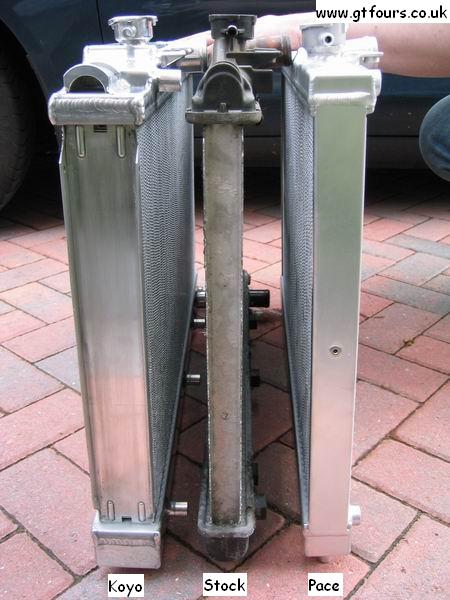

Is a Pace one not beefy enough?
