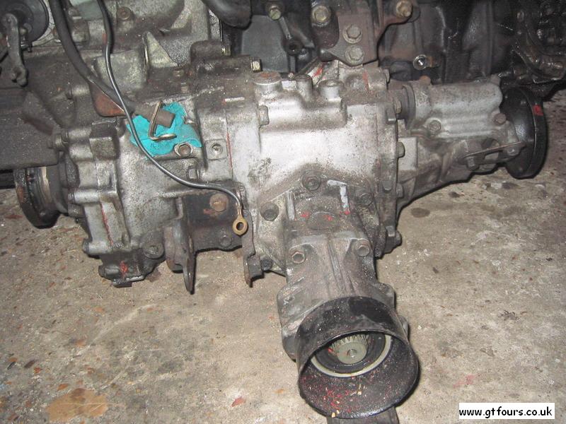

The st185 box has a lever to switch to 2 alternative modes for garage use only.
1. Open centre diff (vc disconnected ) Max speed difference 20mph (from memory )
2. Fwd. Very limited torque.
The st205 doesn't have this lever.
PostPosted: Mon Jul 25, 2011 8:35 pm
You can view the selector lever here on a 165 box - triangular plate top right...
