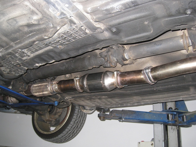

I use a 3" down and midpipe from Aussi in combination with a HKS silent high power on my ST185 CS. Was a bolt on solution. The only thing we´ve done to it was to weld a steel cat into the straight pipe of the midpipe:

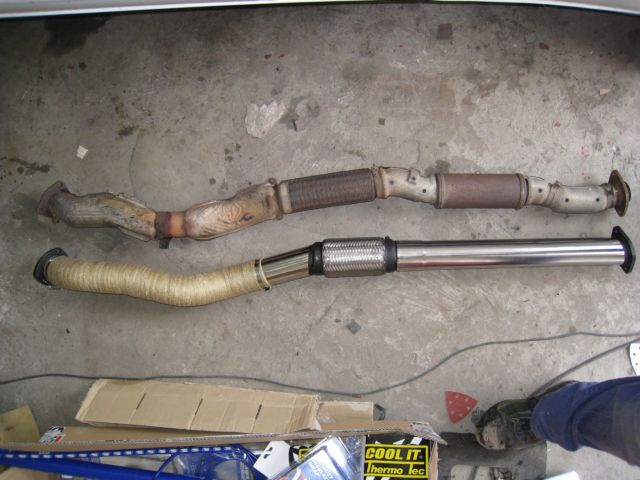

The Aussi midpipe is a direct replacement to the stock mid pipe and got flanges on both ends to fit up with stock or after market exaust systems in the rear end and a stock kat or downpipe in the front.
Stock vs. Aussi mid pipe:

flange will be much better. Xlarge, I'm curious as to what cat have you got there and where'd you get it from? Also how well did it perform?
PostPosted: Sun Nov 13, 2011 8:53 pm
It´s an universal 100 CPI steelcat, fitted with a set of universal flanges. Bought the cat from a german online shop. We´ve welded it in back there because it will reduce the gas flow only minimal.
Driving without a cat was no option as removing the cat from a car that got a cat stock is not legal here in Germany and against the local tax laws.
It performs very well. I don´t feel a power loss from driving without cat and even as it´s only a 100 CPI cat it is effective enough to manage the smoke test cars have to do every two years here.
