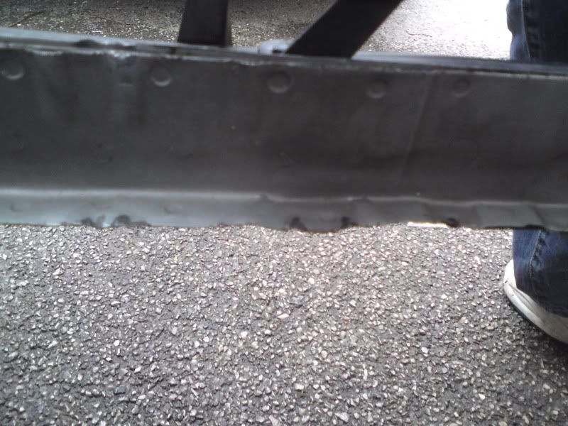

Well, day 2 brings mixed fortunes. Its had a front end knock at some point in its life, nothing too bad, a couple of dented cross members (now straight) also there are signs of a respray, yet to find out why, some on the roof so I.m hoping nothing too drastic to the main shell. still no signs of rust which is good.
should have taken before and after pics really, but I forgot.
This was dented to buggery from where I`d towed it onto the low loader with a chain, managed to get 99% of the dents out
also at the back. this was crushed to hell for some reason, managed to beat it back into almost perfect shape
Signs of some slight crash damage, managed to get it back into more or less perfect shape

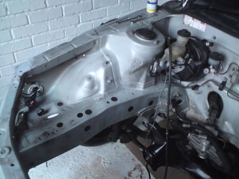

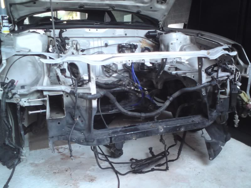

Managed to do a bit today.....wire brushed some of the rusty bits and sprayed with rust eating undercoat. Removed some more bits. Did fond one or two disappointing things, one being the addition of some bolt holes through the lower cross member which I'll have to weld up, no biggy.
Also the engine mounting bot holes on the left side chassis member has been badly cross threaded so I will have to retap it...other than those its still looking like a good un....over all, very clean.
I think the electrical loom is shot...have drained about a litre of horrid looking water from the various electrical pathways.
The very front end pretty much stripped and rust sorted (still need to rust proof the insides of the chassis rails
the drivers side inner wing is near perfect condition, virtually no rust at all...just the toublesome cross threaded engine mount point to re tap.
still alot to remove from the bulkhead
When I undid the home made (bolt through the subframe) power steering oil cooler mounting brackets.....nearly half a litre of rusty water drained out....gonna need some work....a few dents to sort out.

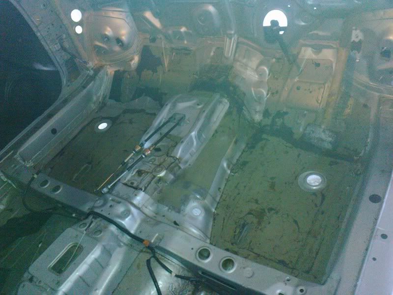

All of the looms are now removed, plastics all gone....pretty much ready for fitting the roll cage now. Have the homologation papers to help me out, although the rules and regulations have changed since 1994/5. For a start, the papers recommend 1.5 & 1mm wall thickness tubing, which is now banned by the FIA so you cant get it anymore, so I have to opt for the currently recommended 2.5mm tubing (40mm OD for those interested) (Thanks as ever to Warner for the info and help...always appreciated mate)
The stripped out footwells. my only problem now is removing the seam sealer which I dont quite know how to do....a bit of research needed.
When I had my cage built I discovered the homologation for the original TTE ST205 cage was about to expire and it would not pass scrutineering, probably for the reasons you have described. My cage is also a bit simpler and thus lighter than the rally cage as mine will only be used for tarmac events. Are you using T45 or CDS tube?
Insanity-74 wrote:
...my only problem now is removing the seam sealer which I dont quite know how to do....a bit of research needed.
Meurz had a problem with the surviving seam sealer and paint when he tried to seam weld the shell on his ST185. All sorts of sputtering and noxious gases :lol: With my shell JEMS laboriously picked out all the sealer before welding. Alternatively you could dip the shell before seam welding using the service of someone like Surface Processing http://www.surfaceprocessing.co.uk/paint-stripping-toyota.html I will probably use them for the final prep of my shell prior to paint.

The sound deadening was easy, just used a big rubber mallet (so I didnt hit my hand too much) and a wide bladed cold chisel, it just breaks off in 2" ish chunks.
For the cage I'll probably be using CDS.
I was advised against dipping my shell by several sprayers and a car restorer. The problem being is that acid leaches between panels and cant be washed out so it eats the car from the inside out. I was recommended burning or not removing all the old paint at all as Toyotas painting process is very good and offers the best all over protection.
You also have to be careful with seam welding...theres a Ford article somewhere about their prep for rallies and what they did for seam welding, and what they did was minimal, only a bit in the engine bay and aroung the engine mounts, they found that seam welding too much had a bad effect on the handling. Its a really interesting read, I'll see if I can dig the article out.
