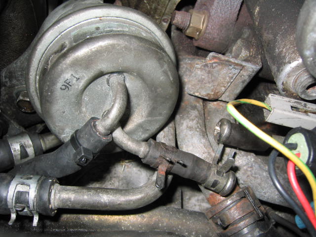

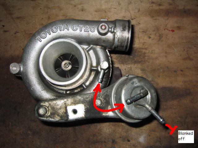

Have a look at www.gtfours.co.uk > How to > Disable TVSV
The principle is this:
Installed it looks like this:
Hope that helps?

Nice pictures kris, is he going to put in some kind of boost control ????

i haev fitted it today finished at 7 took it our for a run to set up. all seems fine. smile came back to my face.
will see how it goes. the pics did help. thamks kris. i musnt've seen for looking.
