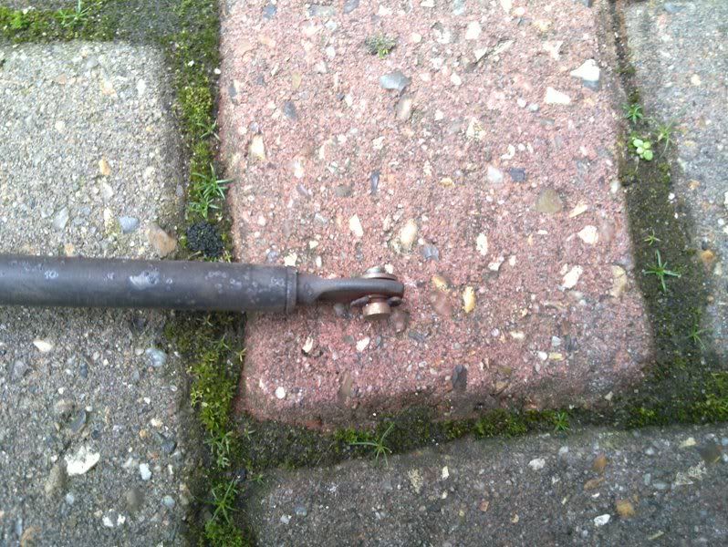

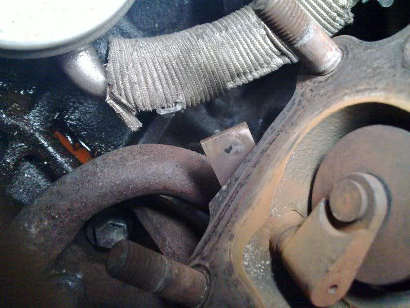

Nothing obvious externally and the turbo appeared to be reasonably intact so I pulled the downpipe off for a better look
What greeted me was this, could have been worse I suppose

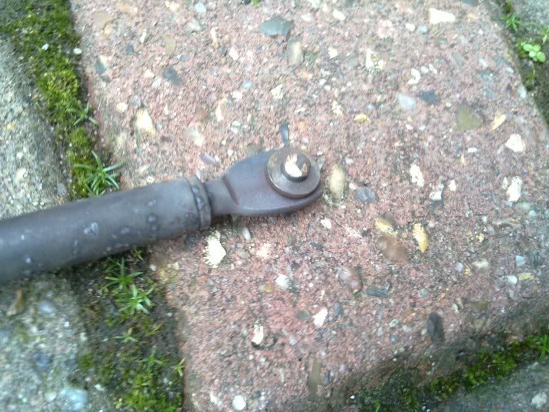

The pin on the wastegate has come clean off :shock:
Now bodged back together with an undersised nut and bolt (some bugger has nicked the batteries for my cordless drill so I had a bit of trouble 'drilling' the wastegate arm out :lol: )
Need to figure out a permanent solution now. I think turbo off and weld a clevis pin in place of the snapped off item. Hopefully the bodge will last until it warms up a bit

That has been slowly failing on you steve - the nature of the rusted/clean shear indicates that.
At least your shaft hasn't snapped (ooo-eerrr mrs). Could be a right royal PITA to fix proper. Turbo removal and probably plenty of heat to removed turbine housing.
oh.... love to say I told you so :-)
