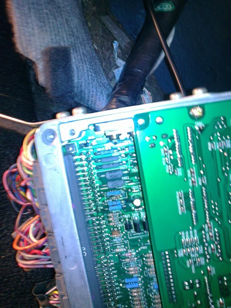

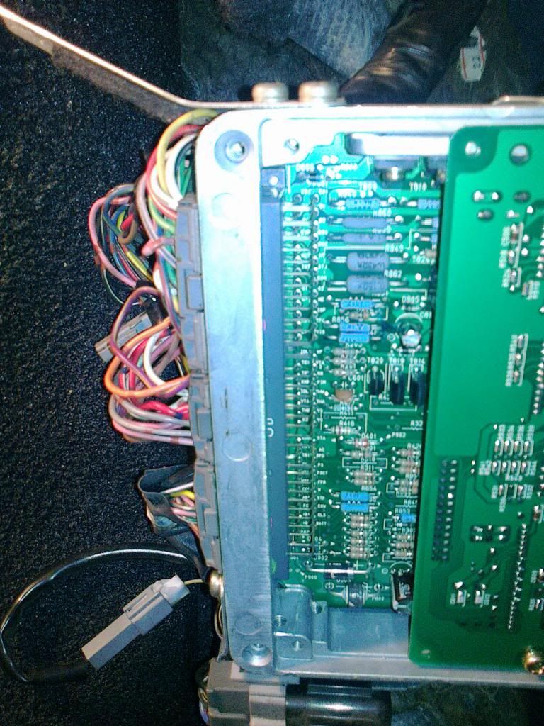

pics of ECU. wow my back is done in and my wrists are sore..... these any good?
There does seem to be a little stain just left of the capacitor, and some below it???

The pictures are a little blurry but there does appear to be a trail of dried capacitor juice leading from the capacitor (the vertical round thing).
Next step, you need to pull the 3 plugs out of the ECU, take the circuit opening relay off the side, screw the lid back on and post it to me. (The ECU, not just the lid :lol: ) I'd suggest special delivery as it's tracked & insured. If you can keep it under 2Kg it's £9 I think & not much more than normal post.
