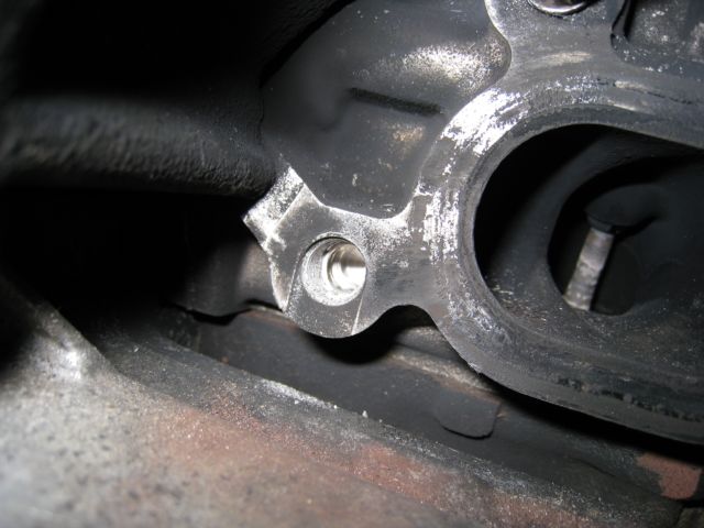

This is what it looks like, with the sooting on the right site of the manifold.
Possibly warped and lifting on the right?

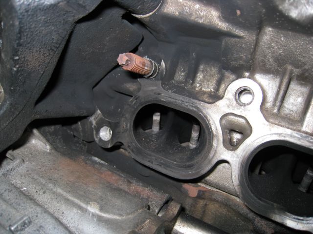

PostPosted: Sun Jan 06, 2013 3:46 pm
It looked the same way on my engine:
Manifold was OK, but the studs wasn´t fixed in the head because of the dead threads. The lower left one was gone complete as You may see in the picture.

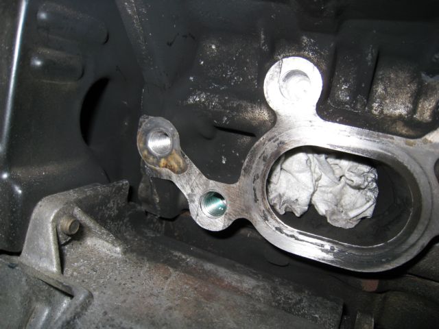

This way the thread looks after the repair with Helicoil:

I'm guessing the usual reason for thread failure in the head is people over-tightening to try to nip up a blow caused by a warped manifold. The manifold is less flexible than the aluminum threads.
My thoughts on the manifold to turbo studs is that steel studs into steel manifold + heat = rusted solid. Steel studs into alli are likely to come out a bit easier. If the turbo ones do come out, it may save some helicoiling.
PostPosted: Sun Jan 06, 2013 10:34 pm
I don´t believe in a warp manifold. I bought my car with the engine build by TRD and only 40 k km on it. I´m nearby sure nobody has tryed to fasten the nuts as try to repair. But what I´ve noticed was that the new original gasket for the manifold had a total different design compared to the one I´ve took out. Maybe the original design of the gasket was weak and caused the blowby.
Didn´t skimmed the manifold and it is still leakproof after four years and 30 k km.
PostPosted: Sun Jan 06, 2013 10:42 pm
If your engine was nearly new then probably the manifold was ok.
All the ones I've put a ruler on have about 1mm gap at one end with other end and centre touching. I've skimmed 2 now for other people plus 1 of my own is in need of it. That's out of 3 I've looked at.
