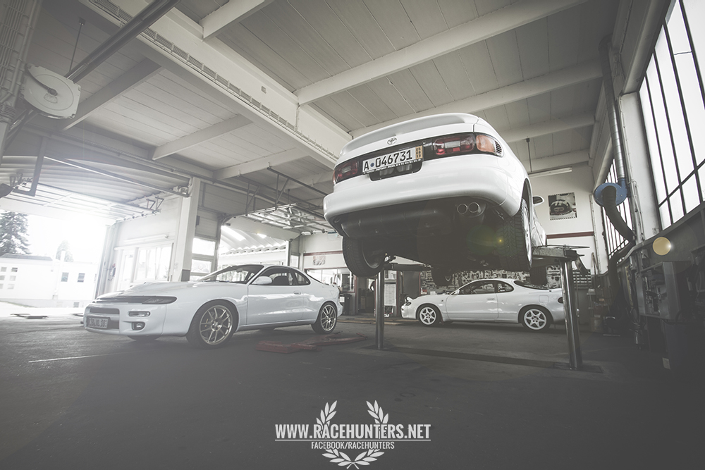

Three german owners of white Celica Carlos Sainz Edition had a minimeet last weekend. We also invited a semi professional photographer we know from the german Toyota-Forum as we wanted to do a fotoshooting.
Here one of the first pictures from that day showing No 1946 (mine, original Toyota Super White 040, now Porsche Firnweiß) , No 2959 ( Wolfgang´s, original Toyota Super White 040 ) and No 2050 ( Marco´s, original Black 205, now Toyota Super White 040 ) :

Looking forward to seeing more pictures.

Great photo. Both of my 205's are in Toyota Super White 040 now :)
PostPosted: Tue Aug 06, 2013 9:40 pm
We took the hole day for the shooting, using multiple spots. There will come much more and much more impressive photos, but they aren´t finished yet. Need some magic of the photographer.

Cool! 8)
PostPosted: Wed Aug 07, 2013 8:27 pm
Great pic - look forward to seeing the others.

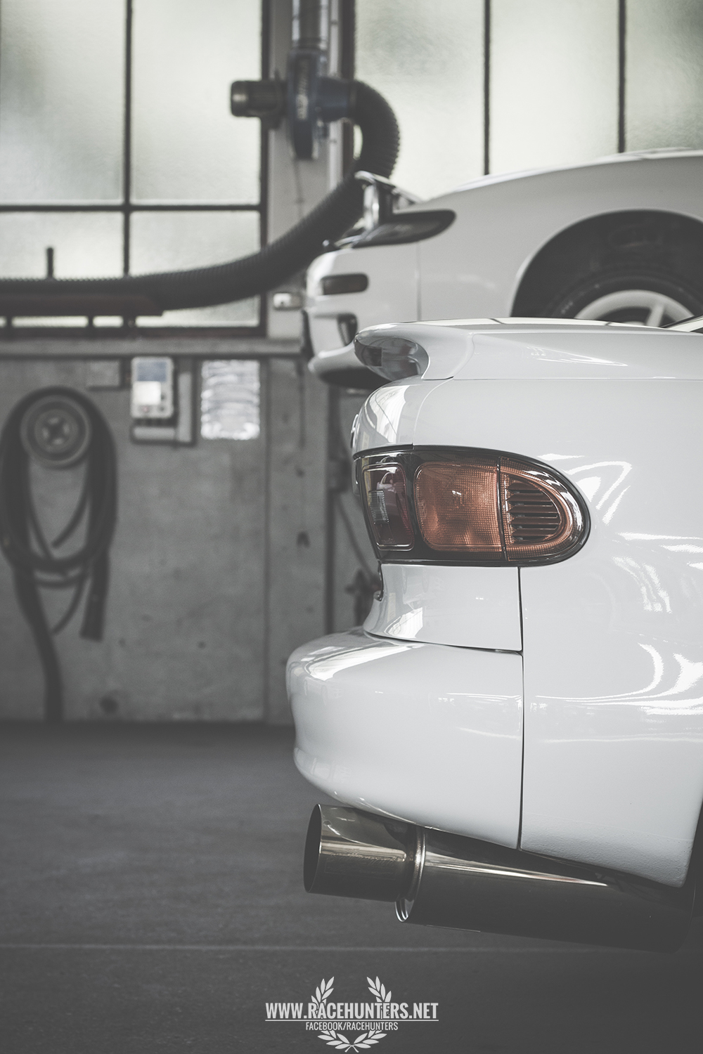

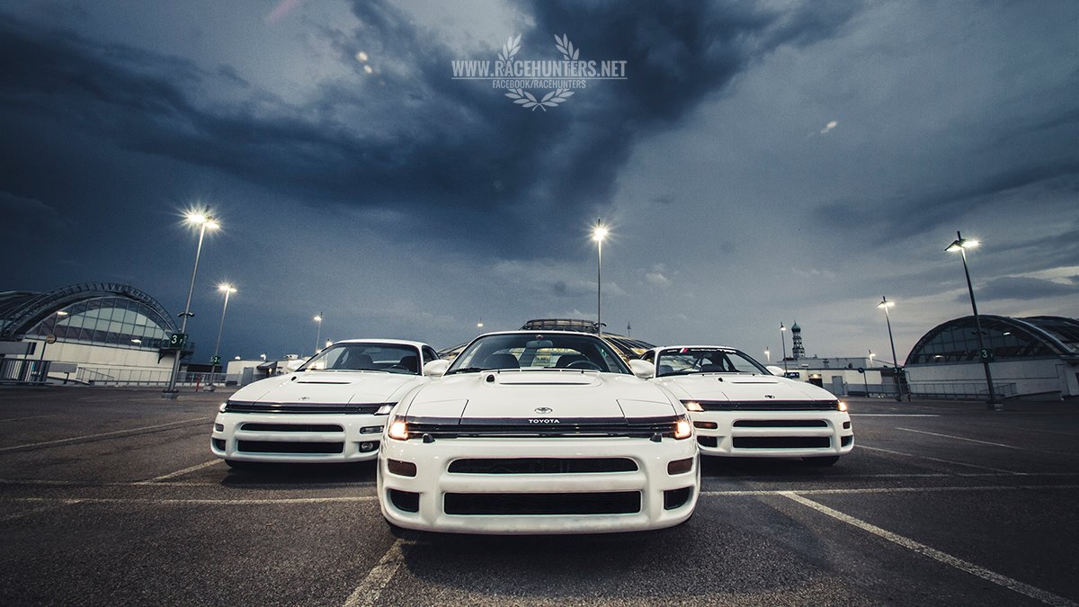

Received the next set of pitures out of that shooting:
Will getting even more and hopefully the full res versions in the next days.

Wow absolutely amazing car
