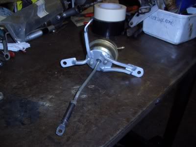

Hi
A new revision of the 165..Turbo actuator clocking bracket
Image.

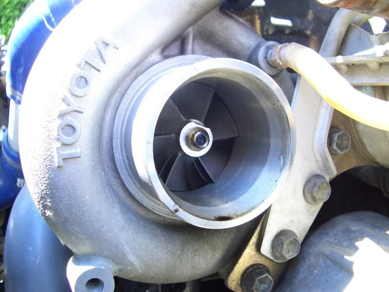

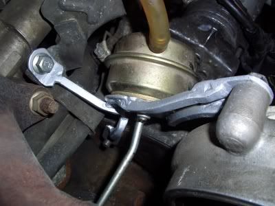

clocked CT20b on a ST185 engine, fitted to my ST165 :D
actuator bracket and installation by datajon:
ST165 turbo 4WD
ST185 GT-FOUR RC Carlos Sainz Limited Edition 825•5000
ST185 turbo 4WD Carlos Sainz Limited Edition 2541•5000
PostPosted: Tue May 23, 2006 8:43 pm
See that your compressor housing has an extra mounting lug...this is very handy when clocking the turbo.
Looks like the 165 amd 185 turbos have this, but the CT20 does not have this extra mounting lug and thus the mounting for the actuator is a bit more traumatic :(

Re: mounting lug. I was under the impression that my turbo is a CT20b MD228 hybrid?
Maybe this has the CT26 compressor housing...seems quite a popular route for the turbo rebuilders?
PostPosted: Tue May 23, 2006 11:48 pm
Owens built the Stage 2 Hybrid for my UK ST205WRC with the turbine from my old CT20b and a compressor housing from a CT26.
My JDM ST205WRC has an MD228 which was on the car when I got it so can't really vouch for its origins. Can take some pics if you're interested.

i thought ct26's had ct26 cast on the housing? confused :? :LOL: :
Think you are correct Gary, but maybe later or aftermarket compressor housings seem not to bear this mark sometimes?
PostPosted: Thu May 25, 2006 7:36 am
All Ct26's have CT26 writrten on the compressor housing.
All Ct20b just have "Toyota" written on the compressor housing.
Turbo builders prefer t start with a Ct26 as teh CHRA has a larger shaft hole and hence it saves machining out the CHRA. CT20b's also have nasty ceramic parts on teh turbine wheel and hence thw whole wheel & shaft need to be replaced. All possible but it is cheaper to give them a Ct26 to start with!
