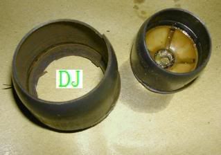

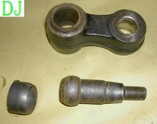

The 205 SS units are rebuildable, have stripped down the lower arm, banana arm & figure of 8, in general failure on ball joint & pivot is from going dry , then rusting causing nylon cup to wear out before it should.
It just a shame they use 3 sorts of taper, otherwise replacement would be very simple.
Grease nipples would increase life span without doubt, this is probably what i shall install.

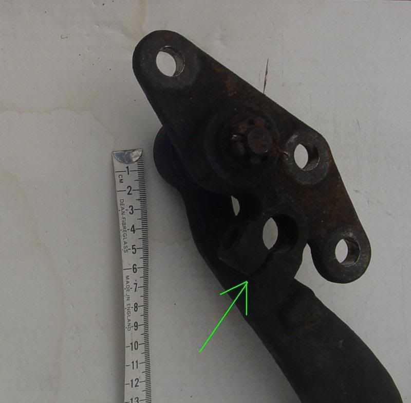

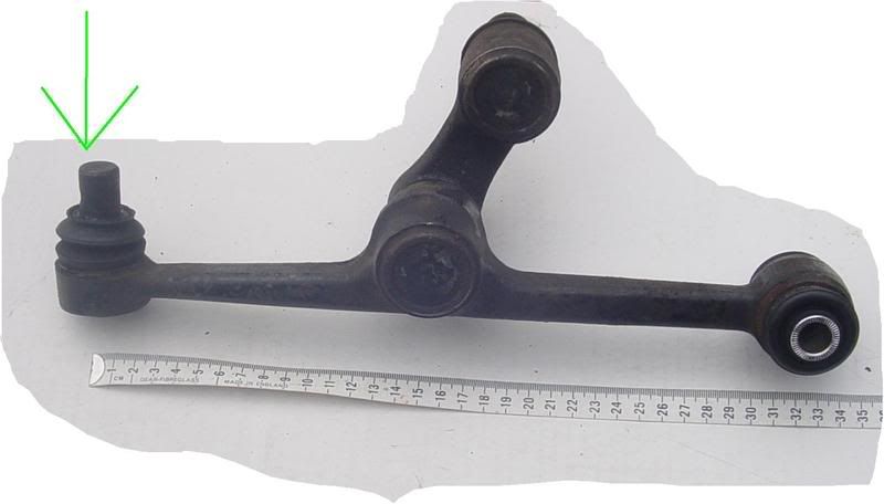

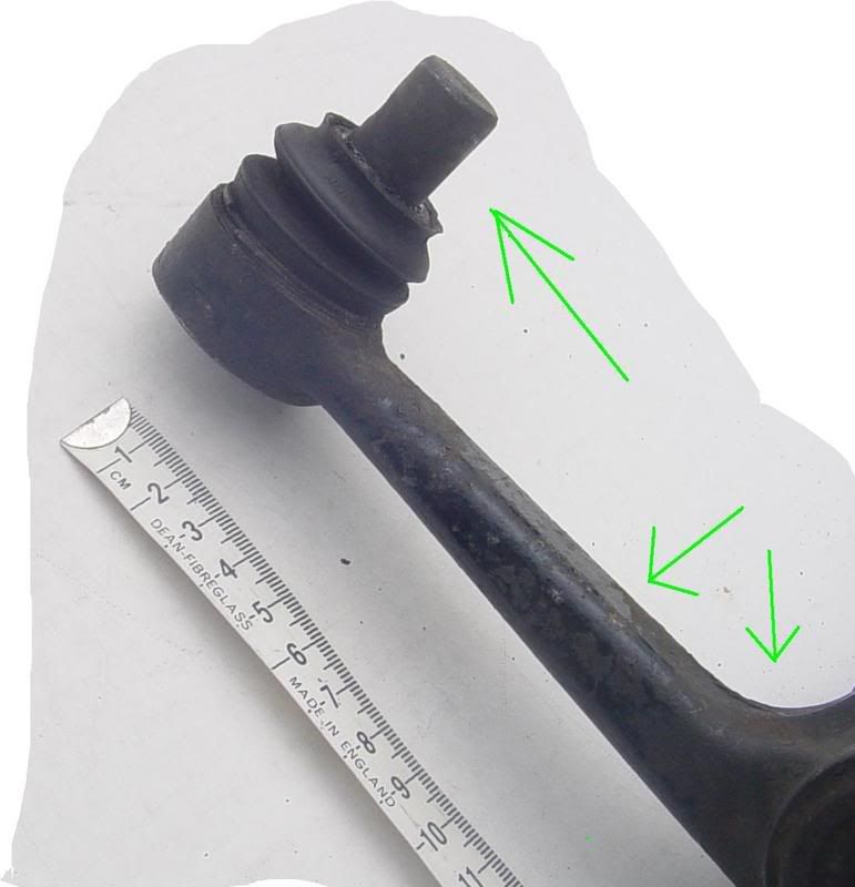

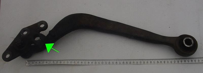

some pictures
the lower arm joint is held in the same way as the figure of 8.
all can be replaced using after market fittings, however its a service i will not be entering, only on entire build programs.

Carina GT SS major parts will not fit ST205.
having received mages from Nick, carina uses clamp style balljoint not taper type, surprised i did not pick that up on the epc.
arms are thiner & smaller.
pictures from nick "carina GT"
